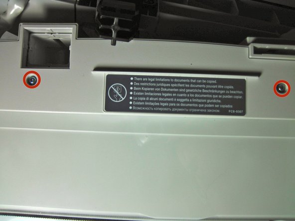

  3. Canon ImageCLASS MF4350d Replace Scanner Glass Replacement: crwdns2935265:03crwdnd2935265:01crwdnd2935265:03crwdne2935265:0 Canon ImageCLASS MF4350d Replace Scanner Glass Replacement: crwdns2935265:03crwdnd2935265:02crwdnd2935265:03crwdne2935265:0 Canon ImageCLASS MF4350d Replace Scanner Glass Replacement: crwdns2935265:03crwdnd2935265:03crwdnd2935265:03crwdne2935265:0
    • Next, locate and remove the four 10mm screws.
