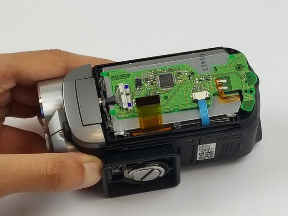

    • Locate battery compartment cover. Turn the device over and locate the battery compartment cover.
    • Place a finger or thumb on the textured section of the battery compartment cover and push forward until you hear a click. Then lift the battery compartment cover.
  2. Canon FS30 LCD Screen Replacement: crwdns2935265:02crwdnd2935265:01crwdnd2935265:02crwdne2935265:0 Canon FS30 LCD Screen Replacement: crwdns2935265:02crwdnd2935265:02crwdnd2935265:02crwdne2935265:0
    • Locate the grey latch and move it aside. The battery is spring loaded and will pop up.
    • Remove the battery.
  3. Canon FS30 LCD Screen Replacement: crwdns2935265:03crwdnd2935265:01crwdnd2935265:02crwdne2935265:0 Canon FS30 LCD Screen Replacement: crwdns2935265:03crwdnd2935265:02crwdnd2935265:02crwdne2935265:0

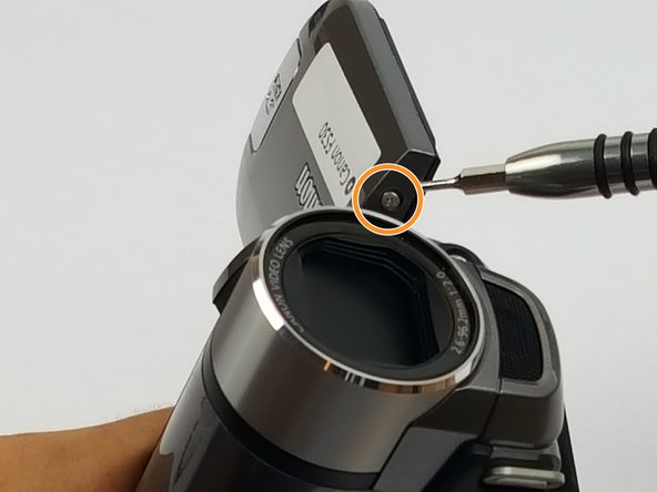

    • Using the Phillips #000, remove the two screws on the LCD panel.
    • Using the Phillips #000, remove two more screws near the LCD panel swivel point.

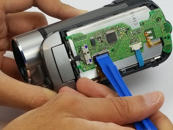

    • Locate and remove two screws on the logic board.
    • Use the plastic opening tool to open the ZIF (zero insertion force) connector. The LCD ribbon should pop up.

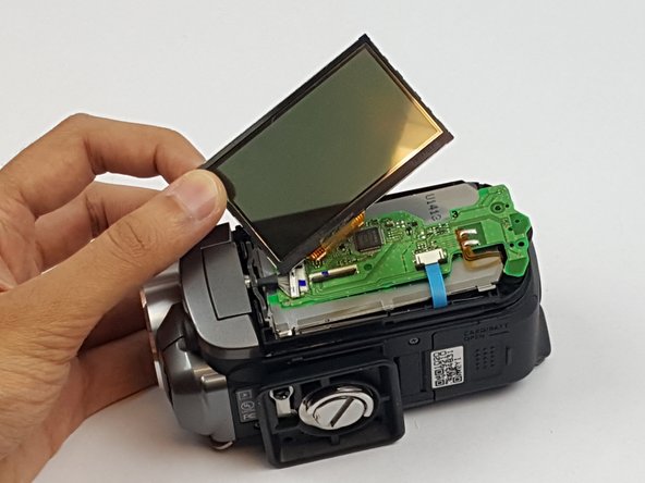

    • Locate the LCD screen underneath the logic board and slide it out.
