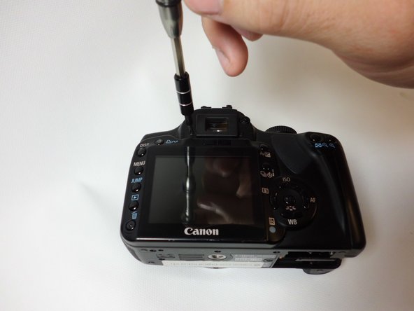

    1. Canon EOS Rebel XTi Shutter Button Replacement, Top Cover: crwdns2935265:015crwdnd2935265:01crwdnd2935265:03crwdne2935265:0 Canon EOS Rebel XTi Shutter Button Replacement, Top Cover: crwdns2935265:015crwdnd2935265:02crwdnd2935265:03crwdne2935265:0 Canon EOS Rebel XTi Shutter Button Replacement, Top Cover: crwdns2935265:015crwdnd2935265:03crwdnd2935265:03crwdne2935265:0
      • Remove the following screws from around the viewfinder:
      • One 10mm JIS #00 diopter screw
      • Two M3x6mm JIS #00 screws

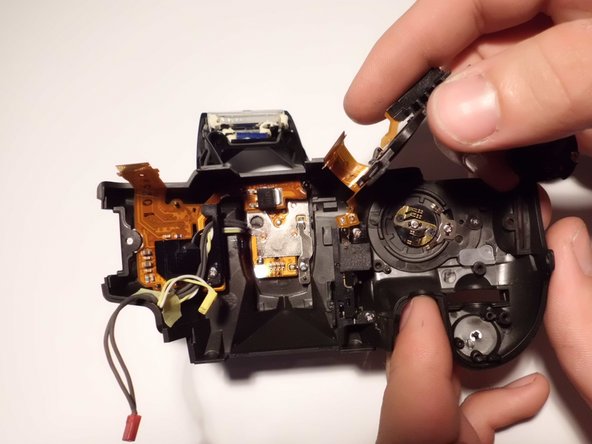

    3. Canon EOS Rebel XTi Shutter Button Replacement: crwdns2935265:017crwdnd2935265:01crwdnd2935265:01crwdne2935265:0
      • Separate the top casing from the electrical components enough to expose the wire harnesses that will need to be disconnected.
      • Ensure to remove the casing gently. There are several wire harnesses connecting the motherboard to components on the casing.
    4. Canon EOS Rebel XTi Shutter Button Replacement: crwdns2935265:018crwdnd2935265:01crwdnd2935265:01crwdne2935265:0
      • Unplug the yellow connector located on the top of the camera.
    5. Canon EOS Rebel XTi Shutter Button Replacement: crwdns2935265:019crwdnd2935265:01crwdnd2935265:01crwdne2935265:0
      • Disconnect the red connector located by the USB port.

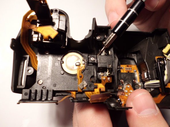

    1. Canon EOS Rebel XTi Shutter Button Replacement, Shutter Button: crwdns2935265:020crwdnd2935265:01crwdnd2935265:01crwdne2935265:0
      • Use a JIS #00 screwdriver to remove the two silver 4 mm screws from underneath the shutter button.
    2. Canon EOS Rebel XTi Shutter Button Replacement: crwdns2935265:021crwdnd2935265:01crwdnd2935265:03crwdne2935265:0 Canon EOS Rebel XTi Shutter Button Replacement: crwdns2935265:021crwdnd2935265:02crwdnd2935265:03crwdne2935265:0 Canon EOS Rebel XTi Shutter Button Replacement: crwdns2935265:021crwdnd2935265:03crwdnd2935265:03crwdne2935265:0
      • Use a JIS #00 screwdriver to remove the 3mm screws from the plate under the shutter button.
      • Place the components off to the side without removing any ribbons.
      • Be careful as ribbon cables are fragile and may rip easily.
    3. Canon EOS Rebel XTi Shutter Button Replacement: crwdns2935265:022crwdnd2935265:01crwdnd2935265:01crwdne2935265:0
      • Use a 1.5mm flat head bit to remove the c-clip from underneath the snapshot button by pushing against the open side of the pin.
