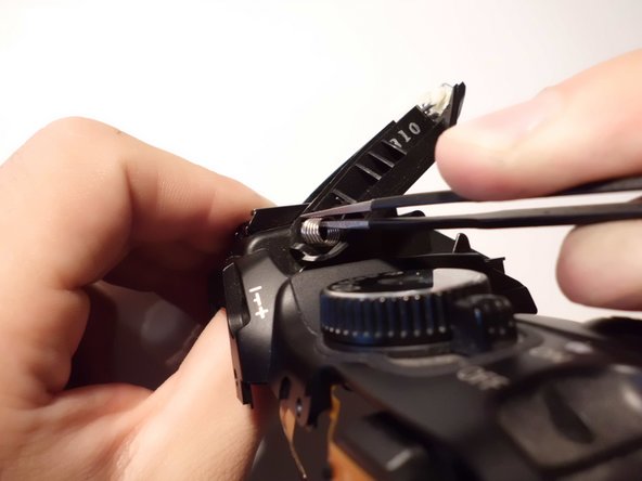

    1. Canon EOS Rebel XTi Flash Module Replacement, Flash Module: crwdns2935265:020crwdnd2935265:01crwdnd2935265:01crwdne2935265:0
      • Use a JIS #000 screwdriver to remove the two 3 mm screws on the retention arms. There is one arm on each side of the module.
      • Do not lose the washers.
      • Remove the Retention Arms.
    2. Canon EOS Rebel XTi Flash Module Replacement: crwdns2935265:021crwdnd2935265:01crwdnd2935265:02crwdne2935265:0 Canon EOS Rebel XTi Flash Module Replacement: crwdns2935265:021crwdnd2935265:02crwdnd2935265:02crwdne2935265:0
      • Use a JIS #000 screwdriver to remove the three 3 mm screws on the flash cap.
      • Remove the flash cap.
    3. Canon EOS Rebel XTi Flash Module Replacement: crwdns2935265:022crwdnd2935265:01crwdnd2935265:02crwdne2935265:0 Canon EOS Rebel XTi Flash Module Replacement: crwdns2935265:022crwdnd2935265:02crwdnd2935265:02crwdne2935265:0
      • Remove the 7mm JIS #000 screw on the flash hinge.
      • Using the straight tweezers remove the spring from the hinge hole.
    4. Canon EOS Rebel XTi Flash Module Replacement: crwdns2935265:023crwdnd2935265:01crwdnd2935265:01crwdne2935265:0
      • Lift the side of the flash module closest to the on/off button towards the opposite side of the camera.
      • Pull the wires gently through the top of the camera to completely remove the flash module.
      • Be Gentle with the wires, even though they have already been disconnected when removing the top casing
