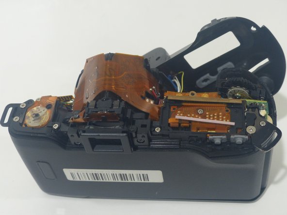

    • Using a PH000 screwdriver bit, remove the three black screws shown in the two pictures that are all 4 mm in length and 1 mm in diameter.
  2. Canon EOS Rebel XS 35mm LCD screen Replacement: crwdns2935265:02crwdnd2935265:01crwdnd2935265:01crwdne2935265:0
    • Using a Phillips #000 screwdriver, remove the two black screws shown in the picture that are both 6 mm in length and 1.25 mm in diameter.
  3. Canon EOS Rebel XS 35mm LCD screen Replacement: crwdns2935265:03crwdnd2935265:01crwdnd2935265:01crwdne2935265:0
    • Pull off the front cover.
  4. Canon EOS Rebel XS 35mm LCD screen Replacement: crwdns2935265:04crwdnd2935265:01crwdnd2935265:03crwdne2935265:0 Canon EOS Rebel XS 35mm LCD screen Replacement: crwdns2935265:04crwdnd2935265:02crwdnd2935265:03crwdne2935265:0 Canon EOS Rebel XS 35mm LCD screen Replacement: crwdns2935265:04crwdnd2935265:03crwdnd2935265:03crwdne2935265:0
    • Using an opening tool (you can also use your nails, but try not to use something potentially damaging to the camera such as metal), separate the top cover from the rest of the camera!
  5. Canon EOS Rebel XS 35mm LCD screen Replacement, LCD screen: crwdns2935265:05crwdnd2935265:01crwdnd2935265:01crwdne2935265:0
    • Using a PH000 screwdriver bit, remove the tiny silver screw circled in the picture, which is 2 mm in length and 1 mm in diameter.
  6. Canon EOS Rebel XS 35mm LCD screen Replacement: crwdns2935265:06crwdnd2935265:01crwdnd2935265:01crwdne2935265:0
    • With your fingers or tweezers, remove the brass-colored part.
  7. Canon EOS Rebel XS 35mm LCD screen Replacement: crwdns2935265:07crwdnd2935265:01crwdnd2935265:02crwdne2935265:0 Canon EOS Rebel XS 35mm LCD screen Replacement: crwdns2935265:07crwdnd2935265:02crwdnd2935265:02crwdne2935265:0
    • With your fingers (probably not tweezers or something similar, so you don't damage the screen), remove the LCD screen.
