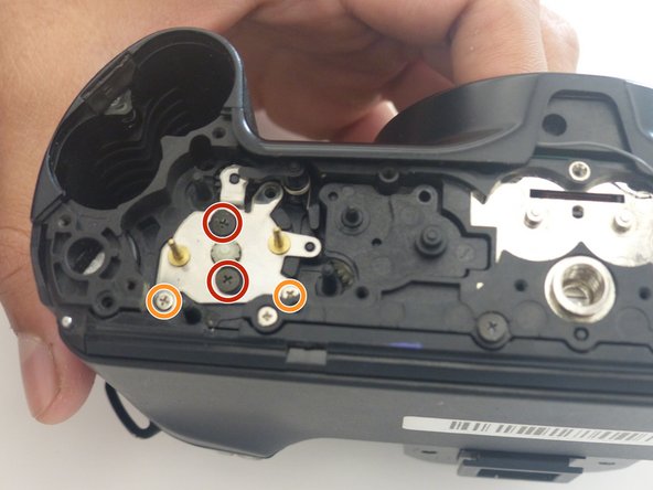

  12. Canon EOS Rebel XS 35mm Bottom Cover and More Replacement: crwdns2935265:012crwdnd2935265:01crwdnd2935265:02crwdne2935265:0 Canon EOS Rebel XS 35mm Bottom Cover and More Replacement: crwdns2935265:012crwdnd2935265:02crwdnd2935265:02crwdne2935265:0
    • Remove two 3mm Phillips #000 screws.
    • Remove two silver 3.5mm Phillips #000 screws.
  13. Canon EOS Rebel XS 35mm Bottom Cover and More Replacement: crwdns2935265:013crwdnd2935265:01crwdnd2935265:01crwdne2935265:0
    • Remove the second silver plate using tweezers or fingers.
