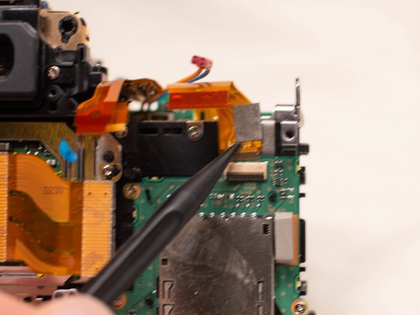

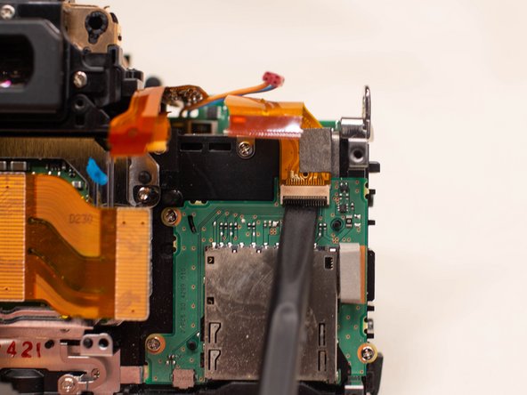

  19. Canon EOS Rebel T5 SD Card Board Replacement, SD Card Board: crwdns2935265:019crwdnd2935265:01crwdnd2935265:03crwdne2935265:0 Canon EOS Rebel T5 SD Card Board Replacement, SD Card Board: crwdns2935265:019crwdnd2935265:02crwdnd2935265:03crwdne2935265:0 Canon EOS Rebel T5 SD Card Board Replacement, SD Card Board: crwdns2935265:019crwdnd2935265:03crwdnd2935265:03crwdne2935265:0
    • Using a pair of tweezers, remove the tape covering the SD card board ribbon cable.
    • Using the plastic spuger, lift up the black locking tab on the SD card board ribbon cable and disconnect the ribbon cable.
  20. Canon EOS Rebel T5 SD Card Board Replacement: crwdns2935265:020crwdnd2935265:01crwdnd2935265:02crwdne2935265:0 Canon EOS Rebel T5 SD Card Board Replacement: crwdns2935265:020crwdnd2935265:02crwdnd2935265:02crwdne2935265:0
    • Remove the three 3mm JIS #000 screws connecting the SD card reader to the back of the device.
    • Carefully lift the SD card board out of the camera.

Very comprehensive tutorial but 2 screws forgotten (on both sides of the viewfinder) and the adjustment thumb knob withdrawal before removing the top panel of the device. Good job anyway, tks
igloo - crwdns2934203:0crwdne2934203:0
Removal of the sensor is NOT required to take the SD board out of the camera. The sensor needs to be fitted back to exactly the same height, otherwise you WILL not retain autofocus. Why was there no mention of this during the steps above?
Lee Gartside - crwdns2934203:0crwdne2934203:0
Bonjour , ou peut on acheter le lecteur de carte sd , merci , cordialement
d007 Éric d007 - crwdns2934203:0crwdne2934203:0
Step 19 and 20 are only for modifiing or replacing the image sensor
And is not recommended because AF doesn't work without further adjustment
Tom Oos Oss - crwdns2934203:0crwdne2934203:0
