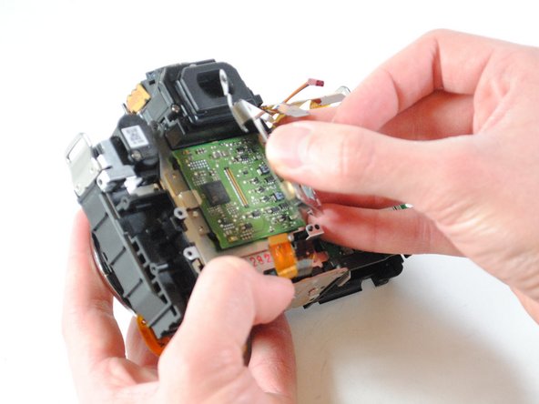

  8. Canon EOS Rebel T5 Image Sensor Replacement, Motherboard: crwdns2935265:08crwdnd2935265:01crwdnd2935265:02crwdne2935265:0 Canon EOS Rebel T5 Image Sensor Replacement, Motherboard: crwdns2935265:08crwdnd2935265:02crwdnd2935265:02crwdne2935265:0
    • Remove all ribbon cables with the plastic spudger.
    • Gently pry up the black plastic tabs to slide out the ribbon cables
    • Take note of this black cable and where it connects to the motherboard. This is a fiber optic cable which is used for the camera flash. It will need to be reconnected after replacing the motherboard.
    • When reconnecting the fiber optic cable, simply push the black cable into the hole in the connector and push it all the way in.

  15. Canon EOS Rebel T5 Image Sensor Replacement, Image Sensor: crwdns2935265:015crwdnd2935265:01crwdnd2935265:02crwdne2935265:0 Canon EOS Rebel T5 Image Sensor Replacement, Image Sensor: crwdns2935265:015crwdnd2935265:02crwdnd2935265:02crwdne2935265:0
    • The screws holding the image sensor in place is set to a very specific height. Unless they are returned to the exact same height after replacement, the camera will no longer be in focus unless the focus is recalibrated.
    • Remove the three silver 3mm JIS #000 screws from the image sensor holder.
    • Remove the image sensor holder.
  16. Canon EOS Rebel T5 Image Sensor Replacement: crwdns2935265:016crwdnd2935265:01crwdnd2935265:03crwdne2935265:0 Canon EOS Rebel T5 Image Sensor Replacement: crwdns2935265:016crwdnd2935265:02crwdnd2935265:03crwdne2935265:0 Canon EOS Rebel T5 Image Sensor Replacement: crwdns2935265:016crwdnd2935265:03crwdnd2935265:03crwdne2935265:0
    • Remove the three remaining silver 3mm JIS #000 screws from the image sensor.
    • Be careful not lose the springs underneath the screws on the image sensor
    • Using your fingers, lift the image sensor from the device.
