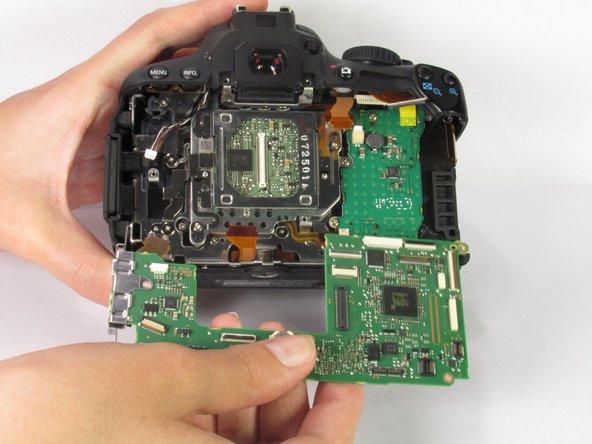

  11. Canon EOS Rebel T4i Motherboard Replacement: crwdns2935265:011crwdnd2935265:01crwdnd2935265:02crwdne2935265:0 Canon EOS Rebel T4i Motherboard Replacement: crwdns2935265:011crwdnd2935265:02crwdnd2935265:02crwdne2935265:0
    • In the upper right corner of the motherboard, use the plastic opening tool to remove the clear cable connector from the motherboard.
  12. Canon EOS Rebel T4i Motherboard Replacement: crwdns2935265:012crwdnd2935265:01crwdnd2935265:02crwdne2935265:0 Canon EOS Rebel T4i Motherboard Replacement: crwdns2935265:012crwdnd2935265:02crwdnd2935265:02crwdne2935265:0
    • Use the plastic opening tool to remove the ribbon cable connecting the image sensor to the motherboard.
  13. Canon EOS Rebel T4i Motherboard Replacement: crwdns2935265:013crwdnd2935265:01crwdnd2935265:02crwdne2935265:0 Canon EOS Rebel T4i Motherboard Replacement: crwdns2935265:013crwdnd2935265:02crwdnd2935265:02crwdne2935265:0
    • Use the plastic opening tool to push on the indents of the plastic header to disconnect from the motherboard.
    • Make sure all cables are disconnected from the motherboard.
  14. Canon EOS Rebel T4i Motherboard Replacement: crwdns2935265:014crwdnd2935265:01crwdnd2935265:02crwdne2935265:0 Canon EOS Rebel T4i Motherboard Replacement: crwdns2935265:014crwdnd2935265:02crwdnd2935265:02crwdne2935265:0
    • Remove the following screws from the motherboard using the JIS #00 screwdriver:
    • Two 3.9mm JIS screws.
    • Three 2.9mm JIS screws
    • Gently pull the motherboard out of the camera.
