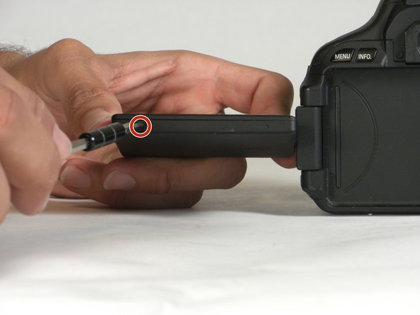

    1. Canon EOS Rebel T3i Screen Replacement, Screen: crwdns2935265:04crwdnd2935265:01crwdnd2935265:02crwdne2935265:0 Canon EOS Rebel T3i Screen Replacement, Screen: crwdns2935265:04crwdnd2935265:02crwdnd2935265:02crwdne2935265:0
      • Remove the two 3 mm JIS #000 screws. The screws are on opposite sides of the screen.

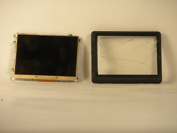

    4. Canon EOS Rebel T3i Screen Replacement: crwdns2935265:07crwdnd2935265:01crwdnd2935265:02crwdne2935265:0 Canon EOS Rebel T3i Screen Replacement: crwdns2935265:07crwdnd2935265:02crwdnd2935265:02crwdne2935265:0
      • Separate the LCD from the plastic housing.
