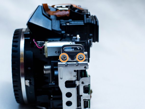

  13. Canon EOS Rebel T3 Strap Anchor Replacement, Strap Anchor: crwdns2935265:013crwdnd2935265:01crwdnd2935265:02crwdne2935265:0 Canon EOS Rebel T3 Strap Anchor Replacement, Strap Anchor: crwdns2935265:013crwdnd2935265:02crwdnd2935265:02crwdne2935265:0
    • On the right side of the camera, remove the following screws:
    • Two 5.5mm JIS #000 screws
    • On the left side, remove the following screws:
    • Two 2.5mm JIS #000 screws
