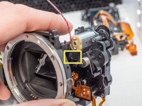

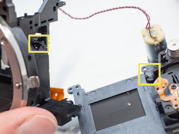

  24. Canon EOS Rebel T3 Shutter Assembly Replacement: crwdns2935265:024crwdnd2935265:01crwdnd2935265:03crwdne2935265:0 Canon EOS Rebel T3 Shutter Assembly Replacement: crwdns2935265:024crwdnd2935265:02crwdnd2935265:03crwdne2935265:0 Canon EOS Rebel T3 Shutter Assembly Replacement: crwdns2935265:024crwdnd2935265:03crwdnd2935265:03crwdne2935265:0
    • On the shutter assembly, remove the following screws:
    • One M1.7x4.5mm Phillips #000 screw
    • One M1.7x7.0mm Phillips #000 screw
    • Also remove the metal tab that is held on by the screw.
    • Carefully lift off the shutter assembly.
    • When reinstalling the shutter assembly, make sure the metal spring gets hooked over the lever for the mirror.
To reassemble your device, follow these instructions in reverse order. When soldering the new cable to the DC PCB board, be sure not to mix up the positive and negative wires.
