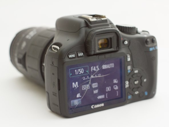

    • Turn the camera off using the power switch on the top of the camera.
    • Open the battery compartment on the bottom of the camera and remove the battery. Then close the battery compartment.

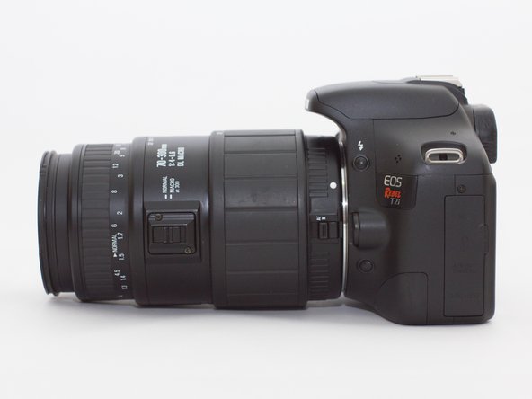

    • While holding both the camera's body and lens securely, press and hold the lens release button located below the marking plate.
    • Rotate the lens counter-clockwise until it stops turning, and gently pull the lens away from the body.
    • Place the lens some place safe. It will not be used in this guide.
    • Secure a rear lens cover onto the lens to protect it from dirt and debris while it is not mounted onto the camera's body.

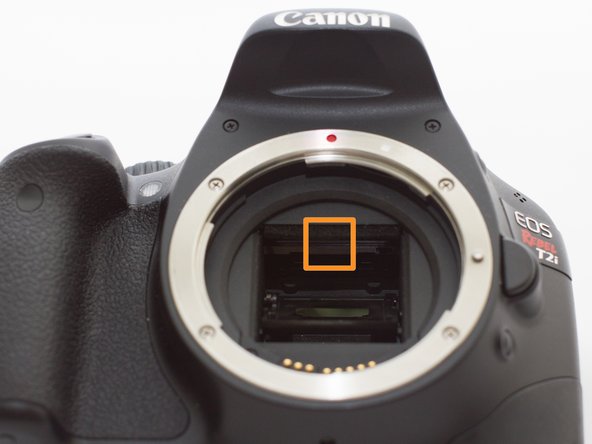

    • The focusing screen is located inside of the body, at the top of the opening, directly above the mirror, inside of a metal housing.
    • Be careful not to touch the mirror.

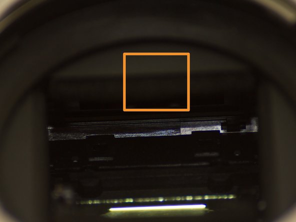

    • To remove the focusing screen, first use tweezers and grab onto the latch that secures the housing above the mirror.
    • Then gently pull down on the latch, towards the mirror, to release the housing which contains the focusing screen.
    • Using tweezers, gently but firmly grab the focusing screen by the outer tab, and lift it out of its housing and the camera's body.
