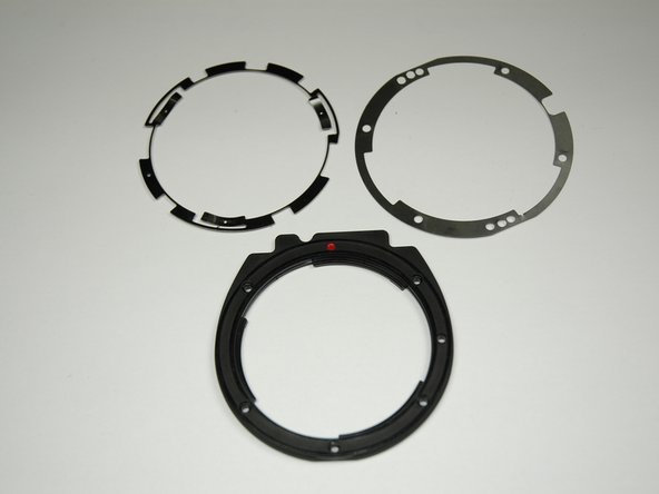

  5. Canon EOS Rebel G Lens Connector Replacement: crwdns2935265:05crwdnd2935265:01crwdnd2935265:01crwdne2935265:0
    • Using your hands, remove the top black ring.
    • WARNING! The indicated piece is spring loaded. Prepare for it to eject when taking off top ring.
    • Spring located here.
  6. Canon EOS Rebel G Lens Connector Replacement: crwdns2935265:06crwdnd2935265:01crwdnd2935265:02crwdne2935265:0 Canon EOS Rebel G Lens Connector Replacement: crwdns2935265:06crwdnd2935265:02crwdnd2935265:02crwdne2935265:0
    • There are two silver metal rings.
    • Remove the top silver metal ring.
  7. Canon EOS Rebel G Lens Connector Replacement: crwdns2935265:07crwdnd2935265:01crwdnd2935265:01crwdne2935265:0
    • Remove the bottom silver ring.
