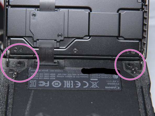

  6. Canon EOS M5 Teardown, Back Case, back: crwdns2935265:06crwdnd2935265:01crwdnd2935265:02crwdne2935265:0 Canon EOS M5 Teardown, Back Case, back: crwdns2935265:06crwdnd2935265:02crwdnd2935265:02crwdne2935265:0
    • Remove 4 metal thread screw.

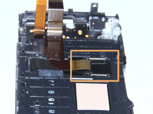

  7. Canon EOS M5 Teardown, Back Case, Detach FPC: crwdns2935265:07crwdnd2935265:01crwdnd2935265:02crwdne2935265:0 Canon EOS M5 Teardown, Back Case, Detach FPC: crwdns2935265:07crwdnd2935265:02crwdnd2935265:02crwdne2935265:0
    • Gently, lift (towards back) and slide the back cover towards left (THE LEFT when you holding the camera)
    • Disconnect 2 FPC.

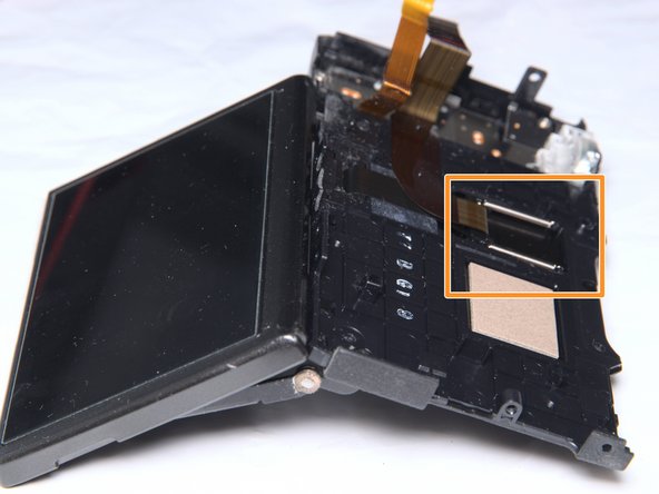

  8. Canon EOS M5 Teardown, The Back Case & Touch LCD.: crwdns2935265:08crwdnd2935265:01crwdnd2935265:03crwdne2935265:0 Canon EOS M5 Teardown, The Back Case & Touch LCD.: crwdns2935265:08crwdnd2935265:02crwdnd2935265:03crwdne2935265:0 Canon EOS M5 Teardown, The Back Case & Touch LCD.: crwdns2935265:08crwdnd2935265:03crwdnd2935265:03crwdne2935265:0
    • The back case with LCD assembly.
    • The beautiful LCD FPC stretcher

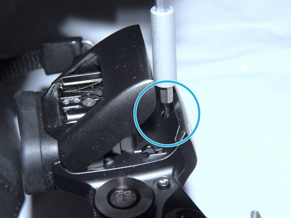

  10. Canon EOS M5 Teardown, Screw, Screw, Screw, Screw: crwdns2935265:010crwdnd2935265:01crwdnd2935265:03crwdne2935265:0 Canon EOS M5 Teardown, Screw, Screw, Screw, Screw: crwdns2935265:010crwdnd2935265:02crwdnd2935265:03crwdne2935265:0 Canon EOS M5 Teardown, Screw, Screw, Screw, Screw: crwdns2935265:010crwdnd2935265:03crwdnd2935265:03crwdne2935265:0
    • Remove 3 screws near the EVF. REMEMBER lengths and hole positions. The center one is longer. The left holes.
    • Pop the speedlight (flash)
    • Remove the screw covered by the speedlight.

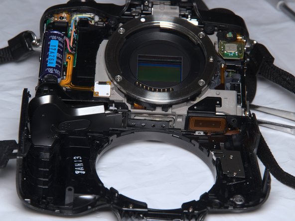

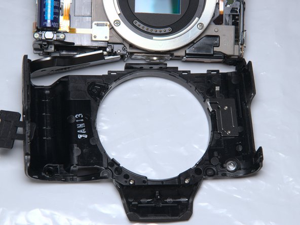

  12. Canon EOS M5 Teardown, Remove Front Case: crwdns2935265:012crwdnd2935265:01crwdnd2935265:03crwdne2935265:0 Canon EOS M5 Teardown, Remove Front Case: crwdns2935265:012crwdnd2935265:02crwdnd2935265:03crwdne2935265:0 Canon EOS M5 Teardown, Remove Front Case: crwdns2935265:012crwdnd2935265:03crwdnd2935265:03crwdne2935265:0
    • Now the front case comes off.
    • There are some clips, be gentle and patient.
  13. Canon EOS M5 Teardown, Front Case and Inside.: crwdns2935265:013crwdnd2935265:01crwdnd2935265:03crwdne2935265:0 Canon EOS M5 Teardown, Front Case and Inside.: crwdns2935265:013crwdnd2935265:02crwdnd2935265:03crwdne2935265:0 Canon EOS M5 Teardown, Front Case and Inside.: crwdns2935265:013crwdnd2935265:03crwdnd2935265:03crwdne2935265:0
    • Please keep body cap on as possible, for shielding again dust.
    • Front cover comes off with 2 small parts. Don't loose them.

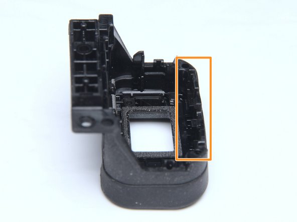

  17. Canon EOS M5 Teardown, EVF Case: crwdns2935265:017crwdnd2935265:01crwdnd2935265:03crwdne2935265:0 Canon EOS M5 Teardown, EVF Case: crwdns2935265:017crwdnd2935265:02crwdnd2935265:03crwdne2935265:0 Canon EOS M5 Teardown, EVF Case: crwdns2935265:017crwdnd2935265:03crwdnd2935265:03crwdne2935265:0
    • Remove EVF plastic case.
    • There are some clips.
    • Remove 1 screw, REMEMBER from which hole!

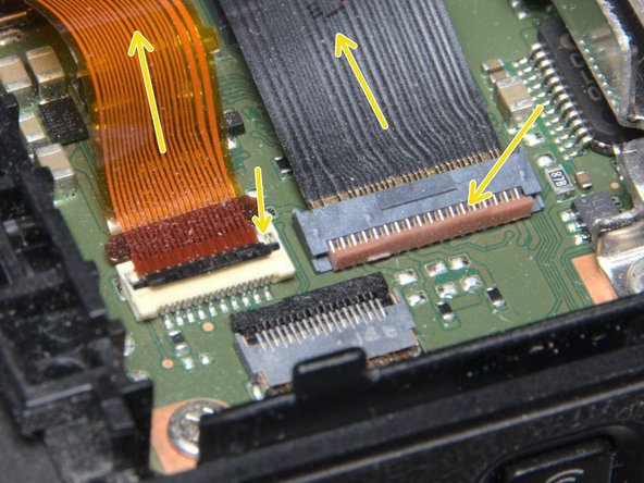

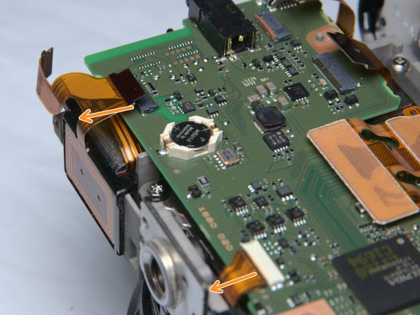

  21. Canon EOS M5 Teardown, Main PCB, 11 FPC's: crwdns2935265:021crwdnd2935265:01crwdnd2935265:03crwdne2935265:0 Canon EOS M5 Teardown, Main PCB, 11 FPC's: crwdns2935265:021crwdnd2935265:02crwdnd2935265:03crwdne2935265:0 Canon EOS M5 Teardown, Main PCB, 11 FPC's: crwdns2935265:021crwdnd2935265:03crwdnd2935265:03crwdne2935265:0
    • IF you can count to 5:
    • PCB top left, detach 2 FPC. 1 ZIF, 1 non-ZIF
    • PCB top right, detach 4 FPC and 1 cable connector
    • PCB top center. detach sensor cable.

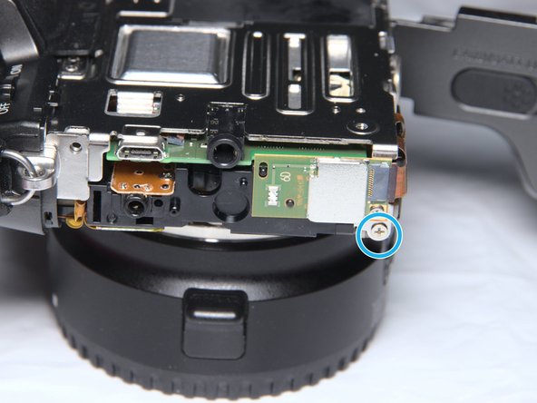

  22. Canon EOS M5 Teardown, Main PCB, more FPC's and screw: crwdns2935265:022crwdnd2935265:01crwdnd2935265:02crwdne2935265:0 Canon EOS M5 Teardown, Main PCB, more FPC's and screw: crwdns2935265:022crwdnd2935265:02crwdnd2935265:02crwdne2935265:0
    • PCB right bottom.
    • Remove 1 screw
    • Detach 1 FPC
    • Detach 2 FPC
  23. Canon EOS M5 Teardown, Enjoy (or Replace) the Main PCB: crwdns2935265:023crwdnd2935265:01crwdnd2935265:02crwdne2935265:0 Canon EOS M5 Teardown, Enjoy (or Replace) the Main PCB: crwdns2935265:023crwdnd2935265:02crwdnd2935265:02crwdne2935265:0
    • Ladies and gentlemen, the mother board
    • Digic and RAM
    • RTC battery
    • Some Flash
    • SD socket
    • Some power supply
