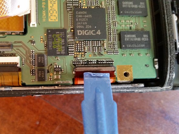

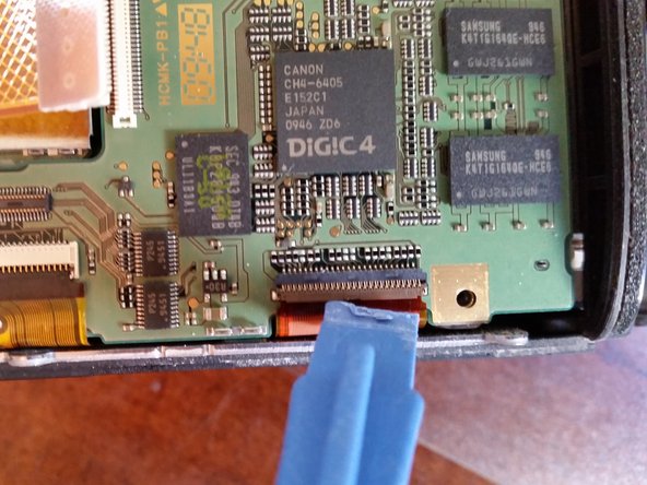

    • Now, the flex cables need to be disconnected.
    • There is no particular order they need to be disconnected in, as long as they all are disconnected.
    • Upon reassembly, it helps to swab all the contacts at the end of the cables with a degreaser such as Isopropyl alcohol.
    • Most of the cables can be disconnected by flipping up a tightening bar.
    • To do so, insert a plastic opening tool under the edge and pry up
    • Now that the cable is lose, use tweezers or just simply your fingers to pull out the cable.
  8. Canon EOS 7D Bent CF Pin Fix/Card Reader Replacement: crwdns2935265:010crwdnd2935265:01crwdnd2935265:01crwdne2935265:0
    • The two middle cables need to be removed next. Use the same process as before, or if no tightening bar is present, gently pull the cable straight out.
  9. Canon EOS 7D Bent CF Pin Fix/Card Reader Replacement: crwdns2935265:011crwdnd2935265:01crwdnd2935265:02crwdne2935265:0 Canon EOS 7D Bent CF Pin Fix/Card Reader Replacement: crwdns2935265:011crwdnd2935265:02crwdnd2935265:02crwdne2935265:0

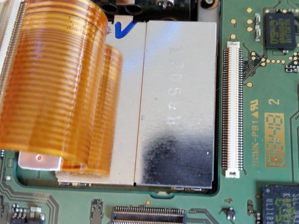

    • Lift up the largest flex cable connecting the sensor to the board.
    • Use a plastic opening tool

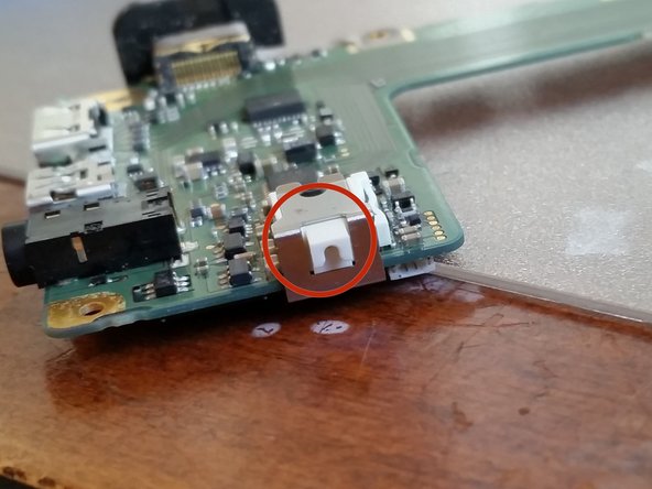

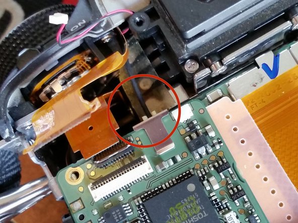

    • The board now is ready to come out. It has a connector on the top right, so it cannot be pulled out quickly. Instead, slide a plastic opening tool under the top right of the board, and pry up.
    • Once the connector is disconnected, carefully remove the board and set it aside.
    • Reassembly: Make sure the black tube goes into the slot on the board, it's easy to miss.

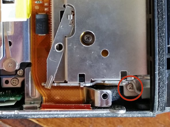

    • With the main board gone, the removal of the card reader can begin.
    • Remove the first two screws securing the reader.
    • Then remove the bottom final screw securing the reader
  17. Canon EOS 7D Bent CF Pin Fix/Card Reader Replacement: crwdns2935265:019crwdnd2935265:01crwdnd2935265:02crwdne2935265:0 Canon EOS 7D Bent CF Pin Fix/Card Reader Replacement: crwdns2935265:019crwdnd2935265:02crwdnd2935265:02crwdne2935265:0
    • The card reader can now be removed
    • Start by pushing the card reader in from the outside slot.
    • Once it's lose, lift the card reader out vertically
    • Insert the new part into the slot, and follow all the steps backwards. See notes for reassembly
