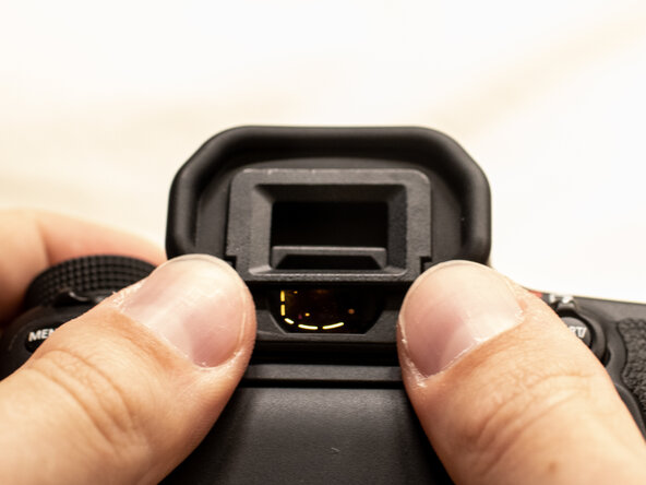

    • Before beginning, remove the battery and SD card from the camera.
    • Using your thumbs, push up on the eyepiece to remove it.
    • Remove the battery door.

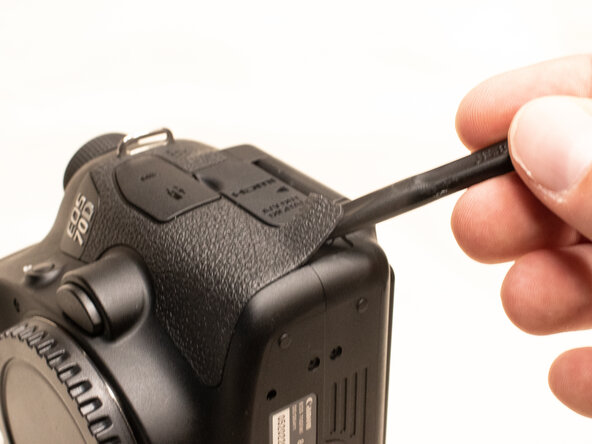

    • Using a plastic spudger tool, peel off the rubber grip on the left side of the camera.
    • Underneath where the rubber grip was, remove the following screws:
    • Three M1.7x5.5mm Phillips #000 screws
    • Pry off the plastic interface cover.
    • Use a plastic opening tool if a fingernail doesn't work.
