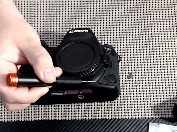

  1. Canon EOS 6D Mark II DC/DC Power Board Replacement, Remove rubber grips: crwdns2935265:01crwdnd2935265:01crwdnd2935265:02crwdne2935265:0 Canon EOS 6D Mark II DC/DC Power Board Replacement, Remove rubber grips: crwdns2935265:01crwdnd2935265:02crwdnd2935265:02crwdne2935265:0
    • Use a plastic pry tool (recommended), a small flathead screwdriver, or your fingernail, to pry up the rubber grips around the camera. There are 3 to remove.
  2. Canon EOS 6D Mark II DC/DC Power Board Replacement, Remove I/O bezel screws: crwdns2935265:02crwdnd2935265:01crwdnd2935265:01crwdne2935265:0
    • Remove 1x Black Phillips 00 screw. (red marker)
    • Remove 3x Silver Phillips 00 screw. (orange marker)
