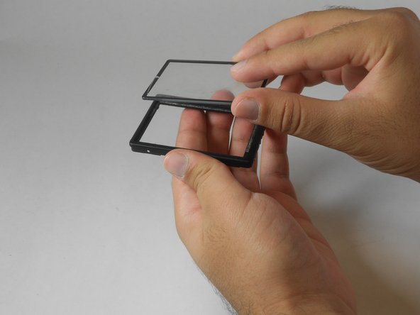

  7. Canon EOS 60D Rear LCD screen protective plastic cover Replacement, Rear LCD screen protective plastic cover: crwdns2935265:07crwdnd2935265:01crwdnd2935265:01crwdne2935265:0
    • Slowly insert the tip of the Jimmy between the damaged plastic cover and the plastic frame, which holds it, to loosen the connection between them.
    • The Jimmy is sharp, so take special care when using it to avoid damaging the plastic frame or causing personal injury.
  8. Canon EOS 60D Rear LCD screen protective plastic cover Replacement: crwdns2935265:08crwdnd2935265:01crwdnd2935265:02crwdne2935265:0 Canon EOS 60D Rear LCD screen protective plastic cover Replacement: crwdns2935265:08crwdnd2935265:02crwdnd2935265:02crwdne2935265:0
    • Carefully slide the Jimmy through all corners of the plastic frame until it is detached from the plastic cover.
  9. Canon EOS 60D Rear LCD screen protective plastic cover Replacement: crwdns2935265:09crwdnd2935265:01crwdnd2935265:02crwdne2935265:0 Canon EOS 60D Rear LCD screen protective plastic cover Replacement: crwdns2935265:09crwdnd2935265:02crwdnd2935265:02crwdne2935265:0
    • Using your hand, lift the detached plastic cover off the plastic frame.
    • To place a new plastic cover, simply stick it to the frame in the appropriate position.

I followed all the steps and was able to dis- and reassamble everything in under 30min. When you reassamble make sure that in step 4 the metalplate of the housing is turned correctly and the connector is in the right position. Both could be turned 180° and mounted incorrectly. Other than that easy repair.
Thanks guys
