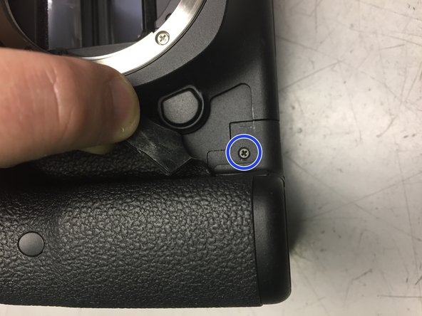

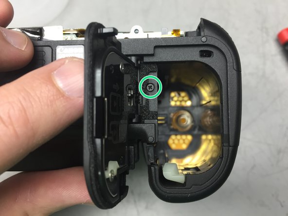

  7. Canon EOS 5D Mark III Main Board Replacement, Remove the bottom plate #1: crwdns2935265:07crwdnd2935265:01crwdnd2935265:03crwdne2935265:0 Canon EOS 5D Mark III Main Board Replacement, Remove the bottom plate #1: crwdns2935265:07crwdnd2935265:02crwdnd2935265:03crwdne2935265:0 Canon EOS 5D Mark III Main Board Replacement, Remove the bottom plate #1: crwdns2935265:07crwdnd2935265:03crwdnd2935265:03crwdne2935265:0
    • Remove these four screws from the bottom plate.
    • Remove this screw from underneath the battery door.
    • Remove this screw from the bottom front right. If you haven't removed the rubber grip material yet, now's the time to just take it off.

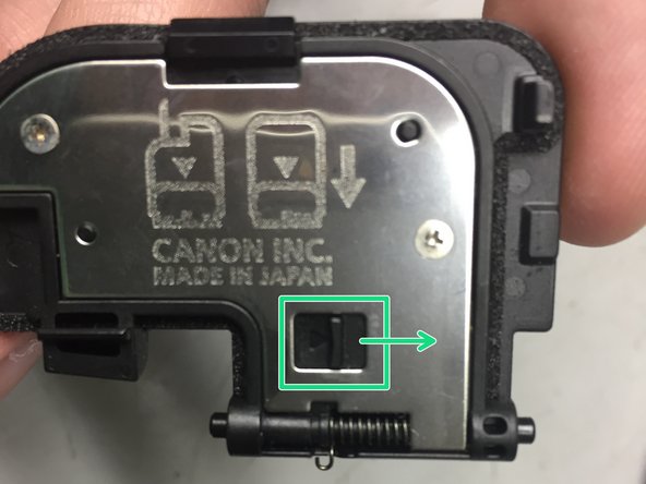

  8. Canon EOS 5D Mark III Main Board Replacement, Remove the bottom plate #2: crwdns2935265:08crwdnd2935265:01crwdnd2935265:03crwdne2935265:0 Canon EOS 5D Mark III Main Board Replacement, Remove the bottom plate #2: crwdns2935265:08crwdnd2935265:02crwdnd2935265:03crwdne2935265:0 Canon EOS 5D Mark III Main Board Replacement, Remove the bottom plate #2: crwdns2935265:08crwdnd2935265:03crwdnd2935265:03crwdne2935265:0
    • Remove this screw.
    • Finish by removing this silver screw.
    • You can remove the battery door at any time if you feel it's in your way. It's not necessary, but it may help. There's a small raised black ridge that can be slid to one side to remove the battery door.
    • It's a tight fit, but wiggle the plate gently and pull straight up and out from the camera body to remove the bottom plate.
