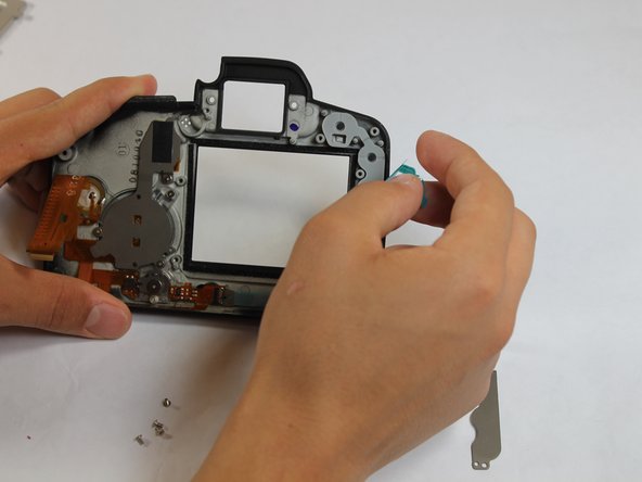

    1. Canon EOS 5D Mark II Rear Button Contact Replacement, Rear Button Contact: crwdns2935265:09crwdnd2935265:01crwdnd2935265:02crwdne2935265:0 Canon EOS 5D Mark II Rear Button Contact Replacement, Rear Button Contact: crwdns2935265:09crwdnd2935265:02crwdnd2935265:02crwdne2935265:0
      • Remove each of the four 4.8 mm screws holding the protective plate over the button contact ribbon cable.
    2. Canon EOS 5D Mark II Rear Button Contact Replacement: crwdns2935265:010crwdnd2935265:01crwdnd2935265:02crwdne2935265:0 Canon EOS 5D Mark II Rear Button Contact Replacement: crwdns2935265:010crwdnd2935265:02crwdnd2935265:02crwdne2935265:0
      • Free the blue data ribbon cable by firmly pressing your thumb over the black clasp at the end of the cable and sliding your thumb to the left. This will raise the clasp and free the cable.
    3. Canon EOS 5D Mark II Rear Button Contact Replacement: crwdns2935265:011crwdnd2935265:01crwdnd2935265:01crwdne2935265:0
      • Pull back the rubber backing found underneath the blue ribbon cable.
    4. Canon EOS 5D Mark II Rear Button Contact Replacement: crwdns2935265:012crwdnd2935265:01crwdnd2935265:01crwdne2935265:0
      • You can now use a brush to clean any built up residue beneath the buttons.
