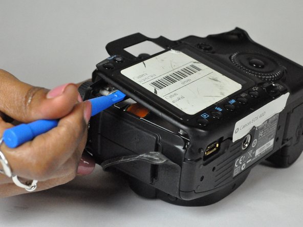

      • Use a plastic opening tool to gently start prying the rear case up from the rest of the camera.

      • Use the tip of a spudger to disconnect the ZIF connector on the left side of the camera.
      • The ribbon cable on this device was torn in the process of removing the back case, so there are no photos showing this step.
      • Disconnect the ribbon cable securing the rear case to the motherboard.
      • Separate the rear case from the camera.
