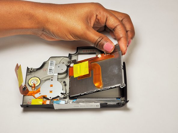

    • Remove the five 5.0 mm Phillips #000 screws securing the LCD to the rear case.
    • Lift the LCD free of the rear case.

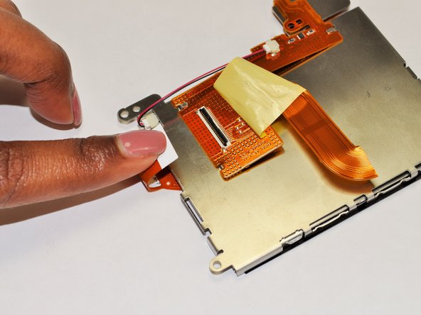

  8. Canon EOS 40D LCD Replacement: crwdns2935265:08crwdnd2935265:01crwdnd2935265:03crwdne2935265:0 Canon EOS 40D LCD Replacement: crwdns2935265:08crwdnd2935265:02crwdnd2935265:03crwdne2935265:0 Canon EOS 40D LCD Replacement: crwdns2935265:08crwdnd2935265:03crwdnd2935265:03crwdne2935265:0
    • Remove the yellow tape covering the LCD ZIF connector.
    • Use a plastic opening tool to lift up the black retaining flap.
    • Pull the LCD ribbon cable out of the connector.
  9. Canon EOS 40D LCD Replacement: crwdns2935265:09crwdnd2935265:01crwdnd2935265:01crwdne2935265:0
    • Use a pair of tweezers to disconnect the cable connector.
    • The LCD frame should now come free of the LCD panel.
