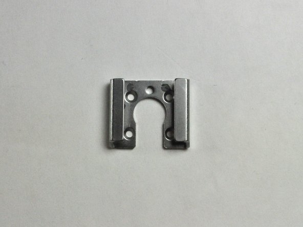

  4. Canon EOS 40D Flash Hot Shoe Replacement, Flash Hot Shoe: crwdns2935265:04crwdnd2935265:01crwdnd2935265:03crwdne2935265:0 Canon EOS 40D Flash Hot Shoe Replacement, Flash Hot Shoe: crwdns2935265:04crwdnd2935265:02crwdnd2935265:03crwdne2935265:0 Canon EOS 40D Flash Hot Shoe Replacement, Flash Hot Shoe: crwdns2935265:04crwdnd2935265:03crwdnd2935265:03crwdne2935265:0
    • Use a metal spudger or opening tool to gently lift the hotshoe plate and slide it off.
  5. Canon EOS 40D Flash Hot Shoe Replacement: crwdns2935265:05crwdnd2935265:01crwdnd2935265:03crwdne2935265:0 Canon EOS 40D Flash Hot Shoe Replacement: crwdns2935265:05crwdnd2935265:02crwdnd2935265:03crwdne2935265:0 Canon EOS 40D Flash Hot Shoe Replacement: crwdns2935265:05crwdnd2935265:03crwdnd2935265:03crwdne2935265:0
    • Remove the four 4.0 mm Phillips #000 screws securing the flash shoe to the camera.
    • Remove the flash shoe.
