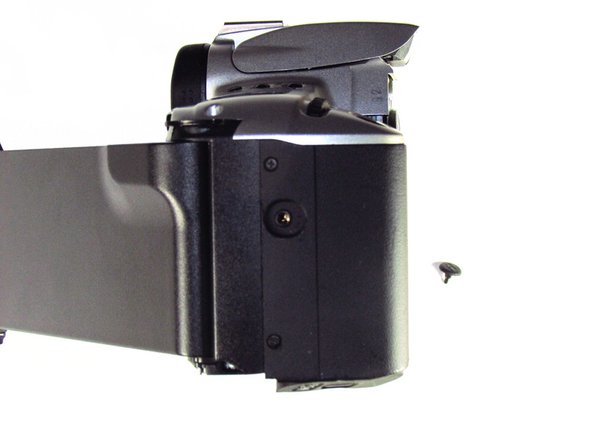

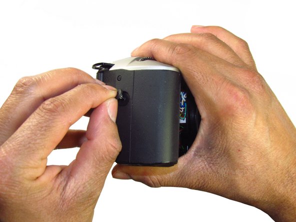

  11. Canon EOS 300 Eyepiece Replacement, Side Panel with Grip: crwdns2935265:011crwdnd2935265:01crwdnd2935265:03crwdne2935265:0 Canon EOS 300 Eyepiece Replacement, Side Panel with Grip: crwdns2935265:011crwdnd2935265:02crwdnd2935265:03crwdne2935265:0 Canon EOS 300 Eyepiece Replacement, Side Panel with Grip: crwdns2935265:011crwdnd2935265:03crwdnd2935265:03crwdne2935265:0
    • Remove the remote control socket cover.
  12. Canon EOS 300 Eyepiece Replacement: crwdns2935265:012crwdnd2935265:01crwdnd2935265:02crwdne2935265:0 Canon EOS 300 Eyepiece Replacement: crwdns2935265:012crwdnd2935265:02crwdnd2935265:02crwdne2935265:0
    • Remove two black 4.5mm Phillips #1 screws.
  13. Canon EOS 300 Eyepiece Replacement: crwdns2935265:013crwdnd2935265:01crwdnd2935265:02crwdne2935265:0 Canon EOS 300 Eyepiece Replacement: crwdns2935265:013crwdnd2935265:02crwdnd2935265:02crwdne2935265:0
    • Remove two black 4.8mm Phillips #1 screws on the front of the camera.
  14. Canon EOS 300 Eyepiece Replacement: crwdns2935265:014crwdnd2935265:01crwdnd2935265:02crwdne2935265:0 Canon EOS 300 Eyepiece Replacement: crwdns2935265:014crwdnd2935265:02crwdnd2935265:02crwdne2935265:0
    • Pry open the side grip using a spudger.
  15. Canon EOS 300 Eyepiece Replacement, Eyecup: crwdns2935265:015crwdnd2935265:01crwdnd2935265:02crwdne2935265:0 Canon EOS 300 Eyepiece Replacement, Eyecup: crwdns2935265:015crwdnd2935265:02crwdnd2935265:02crwdne2935265:0
    • With your hands, remove the rubber grip from the eye piece.

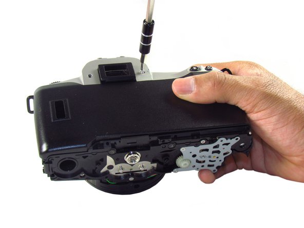

  17. Canon EOS 300 Eyepiece Replacement, Top Panel: crwdns2935265:017crwdnd2935265:01crwdnd2935265:02crwdne2935265:0 Canon EOS 300 Eyepiece Replacement, Top Panel: crwdns2935265:017crwdnd2935265:02crwdnd2935265:02crwdne2935265:0
    • Remove two silver 5.0mm Phillips #1 screws.
  18. Canon EOS 300 Eyepiece Replacement: crwdns2935265:018crwdnd2935265:01crwdnd2935265:01crwdne2935265:0
    • Remove the silver 5.5mm Phillips #1 screw.

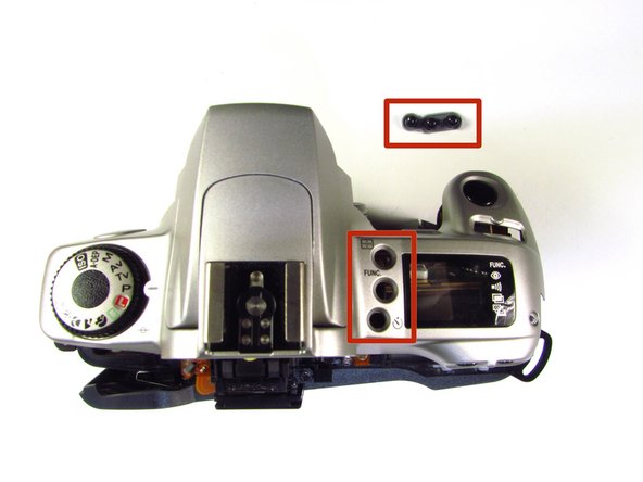

  19. Canon EOS 300 Eyepiece Replacement: crwdns2935265:019crwdnd2935265:01crwdnd2935265:02crwdne2935265:0 Canon EOS 300 Eyepiece Replacement: crwdns2935265:019crwdnd2935265:02crwdnd2935265:02crwdne2935265:0
    • Pry the top silver part of the camera off.
    • Buttons may slip out of the camera's top as the top is pulled off the camera (shown in picture two).

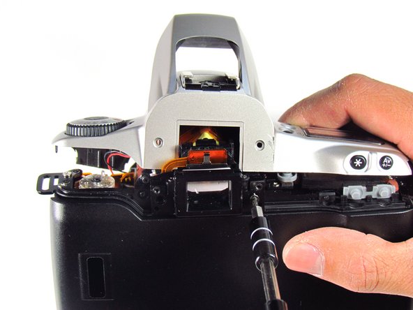

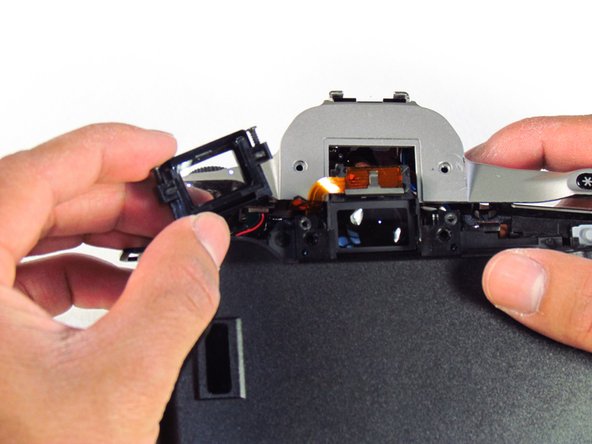

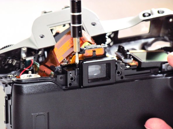

  20. Canon EOS 300 Eyepiece Replacement, Eyepiece: crwdns2935265:020crwdnd2935265:01crwdnd2935265:02crwdne2935265:0 Canon EOS 300 Eyepiece Replacement, Eyepiece: crwdns2935265:020crwdnd2935265:02crwdnd2935265:02crwdne2935265:0
    • Remove the two black 9.5mm screws.
  21. Canon EOS 300 Eyepiece Replacement: crwdns2935265:021crwdnd2935265:01crwdnd2935265:03crwdne2935265:0 Canon EOS 300 Eyepiece Replacement: crwdns2935265:021crwdnd2935265:02crwdnd2935265:03crwdne2935265:0 Canon EOS 300 Eyepiece Replacement: crwdns2935265:021crwdnd2935265:03crwdnd2935265:03crwdne2935265:0
    • Remove two black 8.8mm Phillips #1 screws with a screw driver.
    • Remove the right screw first (the one without the tape).
