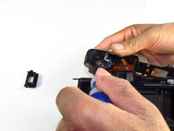

  19. Canon EOS 300 Command Dial Replacement: crwdns2935265:019crwdnd2935265:01crwdnd2935265:02crwdne2935265:0 Canon EOS 300 Command Dial Replacement: crwdns2935265:019crwdnd2935265:02crwdnd2935265:02crwdne2935265:0
    • Pry the top silver part of the camera off.
    • Buttons may slip out of the camera's top as the top is pulled off the camera (shown in picture two).

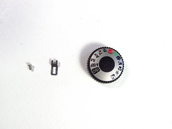

  20. Canon EOS 300 Command Dial Replacement, Command Dial: crwdns2935265:020crwdnd2935265:01crwdnd2935265:03crwdne2935265:0 Canon EOS 300 Command Dial Replacement, Command Dial: crwdns2935265:020crwdnd2935265:02crwdnd2935265:03crwdne2935265:0 Canon EOS 300 Command Dial Replacement, Command Dial: crwdns2935265:020crwdnd2935265:03crwdnd2935265:03crwdne2935265:0
    • On the top panel, remove the silver 3.8mm Phillips #1 screw right below the command dial.
    • A small metal piece will come off with the screw.
