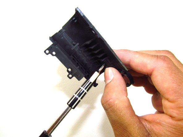

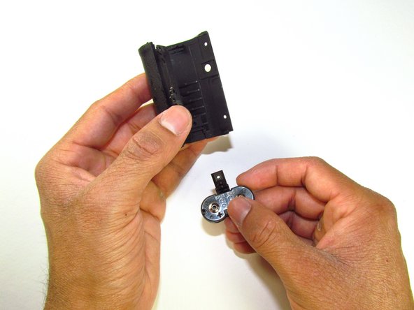

  15. Canon EOS 300 Battery Door Replacement, Battery Door: crwdns2935265:015crwdnd2935265:01crwdnd2935265:03crwdne2935265:0 Canon EOS 300 Battery Door Replacement, Battery Door: crwdns2935265:015crwdnd2935265:02crwdnd2935265:03crwdne2935265:0 Canon EOS 300 Battery Door Replacement, Battery Door: crwdns2935265:015crwdnd2935265:03crwdnd2935265:03crwdne2935265:0
    • Remove one black 5mm Phillips #1 screw.

When reassembling, make sure to attach the spring shown in step 8 to the film back release mechanism. I missed this the first time I reassembled the camera and the release/close slide would not automatically close like it did before. I found keeping a finger over the bottom post and using the SIM removal bit to stretch the spring to the top of the slide was very useful. Overall great guide! Thanks for posting!
