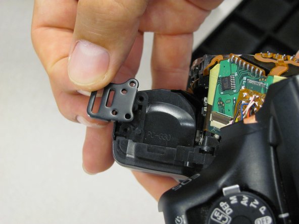

    • Slide the outer eyepiece upward to remove it.
  2. Canon EOS 30 Strap Loops Replacement: crwdns2935265:02crwdnd2935265:01crwdnd2935265:01crwdne2935265:0
    • Remove the two 4.75 mm black screws located on the top of the camera.
  3. Canon EOS 30 Strap Loops Replacement: crwdns2935265:03crwdnd2935265:01crwdnd2935265:01crwdne2935265:0
    • Remove the four 4.3 mm black screws near the bottom corners of the eyepiece at the back of the camera.
  4. Canon EOS 30 Strap Loops Replacement: crwdns2935265:04crwdnd2935265:01crwdnd2935265:02crwdne2935265:0 Canon EOS 30 Strap Loops Replacement: crwdns2935265:04crwdnd2935265:02crwdnd2935265:02crwdne2935265:0
    • Slowly separate the top panel from the camera by pushing it upward.
    • Separating the top panel too far or quickly can damage the ribbon cable and connecting wires that are still attached to the top panel of the camera.
  5. Canon EOS 30 Strap Loops Replacement, Strap Loops: crwdns2935265:05crwdnd2935265:01crwdnd2935265:02crwdne2935265:0 Canon EOS 30 Strap Loops Replacement, Strap Loops: crwdns2935265:05crwdnd2935265:02crwdnd2935265:02crwdne2935265:0
    • Remove two 5.9 mm silver screws on top of camera to detach left strap loop (opposite grip).
  6. Canon EOS 30 Strap Loops Replacement: crwdns2935265:06crwdnd2935265:01crwdnd2935265:02crwdne2935265:0 Canon EOS 30 Strap Loops Replacement: crwdns2935265:06crwdnd2935265:02crwdnd2935265:02crwdne2935265:0
    • Remove one 8.5 mm silver screw (front) and one 5.45 mm silver screw (back) to remove strap loop near LCD screen.
