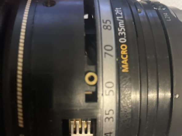

  4. Canon EF-S 17-85mm lens Disassembly/fix: crwdns2935265:04crwdnd2935265:01crwdnd2935265:02crwdne2935265:0 Canon EF-S 17-85mm lens Disassembly/fix: crwdns2935265:04crwdnd2935265:02crwdnd2935265:02crwdne2935265:0
    • Remove the rubber zoom grip from the lens.
    • Peel off the dust shield.
    • The dust shield is a flexible black piece of plastic that looks similar to electrical tape.
    • Unscrew the one screw underneath the dust shield and remove the zoom brush (the piece of metal the screw holds in place).
    • The zoom brush is comprised of ten fragile pins. Please use caution while handling this part, as damage to its pins may result in losing function of the autofocus on the lens.
  5. Canon EF-S 17-85mm lens Disassembly/fix: crwdns2935265:05crwdnd2935265:01crwdnd2935265:02crwdne2935265:0 Canon EF-S 17-85mm lens Disassembly/fix: crwdns2935265:05crwdnd2935265:02crwdnd2935265:02crwdne2935265:0
    • There are three screws located in the slots around the zoom ring. For each one:
    • Remove the screw.
    • Pull out the metal spacer using a pair of tweezers.

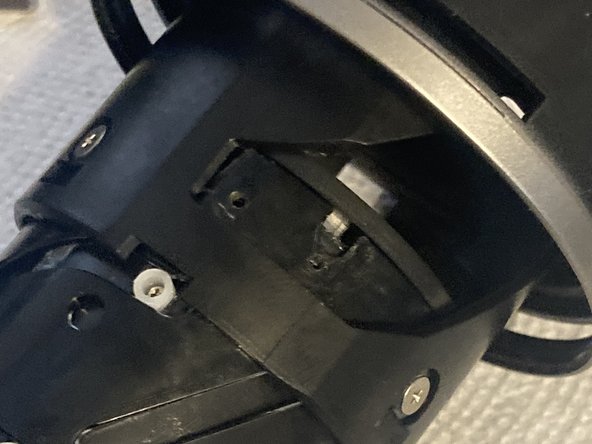

  7. Canon EF-S 17-85mm lens Disassembly/fix: crwdns2935265:07crwdnd2935265:01crwdnd2935265:02crwdne2935265:0 Canon EF-S 17-85mm lens Disassembly/fix: crwdns2935265:07crwdnd2935265:02crwdnd2935265:02crwdne2935265:0
    • During my disassembly these two tiny screws appeared along with this metal bar. Turns put this was the cause of my issues. I found where it belongs and screwed it back in.
    • Assembly is these steps but backwards. Be sure when reassembling the lens housing make sure to line up the black rod with the 2 prong silver fork or your zoom will no longer work.
To reassemble your device, follow these instructions in reverse order. Be sure to line up the black rod with the 2 prong silver fork when putting the lens back with the housing.
