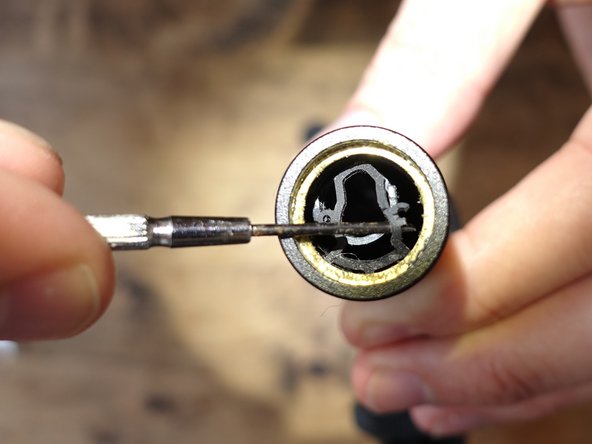

  4. Canon DM-100 microphone rattle noise fix, Remove rubber band: crwdns2935265:04crwdnd2935265:01crwdnd2935265:02crwdne2935265:0 Canon DM-100 microphone rattle noise fix, Remove rubber band: crwdns2935265:04crwdnd2935265:02crwdnd2935265:02crwdne2935265:0
    • Rubber band is irreparable and needs to go. I scratched it out using a small, sharp screwdriver.
  5. Canon DM-100 microphone rattle noise fix, Clean slate: crwdns2935265:05crwdnd2935265:01crwdnd2935265:01crwdne2935265:0
    • The culprit of the rattling noise is now apparent. A plastic cylinder stretches through the whole of the microphone, enabling the microphones forward focused / directional sound.
    • When the rubber band breaks because of the bad joints, this thing hits the inner side of the cylinder.

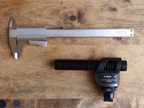

  6. Canon DM-100 microphone rattle noise fix, Find stuffing: crwdns2935265:06crwdnd2935265:01crwdnd2935265:03crwdne2935265:0 Canon DM-100 microphone rattle noise fix, Find stuffing: crwdns2935265:06crwdnd2935265:02crwdnd2935265:03crwdne2935265:0 Canon DM-100 microphone rattle noise fix, Find stuffing: crwdns2935265:06crwdnd2935265:03crwdnd2935265:03crwdne2935265:0
    • I measured the internal diameter, and found that there in total was a void of about 2mm in between the tube and the mic cylinder.
    • After some searching, I found a 2mm thick foam sheet for about 50 cents at a hobbyist shop.
    • Use this to cut a small sheet of depth of about 2 cm and length matching the inner circumference.

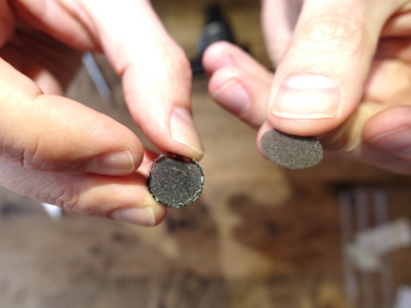

  7. Canon DM-100 microphone rattle noise fix, Stuff it: crwdns2935265:07crwdnd2935265:01crwdnd2935265:01crwdne2935265:0
    • After some scissoring, you should have something that looks a bit like this.
  8. Canon DM-100 microphone rattle noise fix, Make it stick.: crwdns2935265:08crwdnd2935265:01crwdnd2935265:01crwdne2935265:0
    • Add a dab of glue around the foam to make sure it stays in place.
