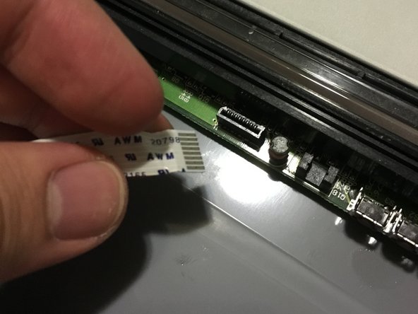

    2. Canon CanoScan N670U Sensor Bar Replacement: crwdns2935265:010crwdnd2935265:01crwdnd2935265:02crwdne2935265:0 Canon CanoScan N670U Sensor Bar Replacement: crwdns2935265:010crwdnd2935265:02crwdnd2935265:02crwdne2935265:0
      • Locate the small plug where the white strip of cable is connected to.
      • Unfurl the cable strip if it's tucked in.

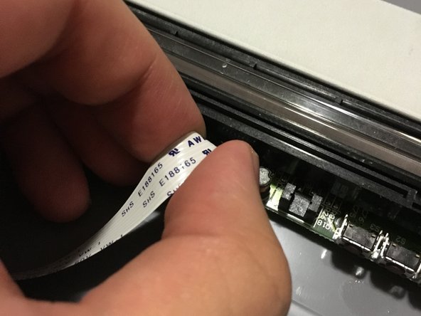

    3. Canon CanoScan N670U Sensor Bar Replacement: crwdns2935265:011crwdnd2935265:01crwdnd2935265:03crwdne2935265:0 Canon CanoScan N670U Sensor Bar Replacement: crwdns2935265:011crwdnd2935265:02crwdnd2935265:03crwdne2935265:0 Canon CanoScan N670U Sensor Bar Replacement: crwdns2935265:011crwdnd2935265:03crwdnd2935265:03crwdne2935265:0
      • Gently use tweezers or your fingers to rock the cable back and forth to disconnect the it.
      • Do not apply too much pressure or you may damage some delicate components.

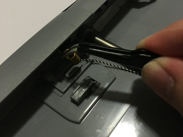

    4. Canon CanoScan N670U Sensor Bar Replacement: crwdns2935265:012crwdnd2935265:01crwdnd2935265:01crwdne2935265:0
      • Locate the small metal spring behind the front buttons of the Canon CanoScan N670U.
    5. Canon CanoScan N670U Sensor Bar Replacement: crwdns2935265:013crwdnd2935265:01crwdnd2935265:02crwdne2935265:0 Canon CanoScan N670U Sensor Bar Replacement: crwdns2935265:013crwdnd2935265:02crwdnd2935265:02crwdne2935265:0
      • Use tweezers to gently remove the metal spring from the plastic hook.
      • Due to the tension of the spring, it can be difficult to pull the metal end. You may attempt to use your hands to pull the spring itself if necessary.
      • Take caution to not bend the metal.

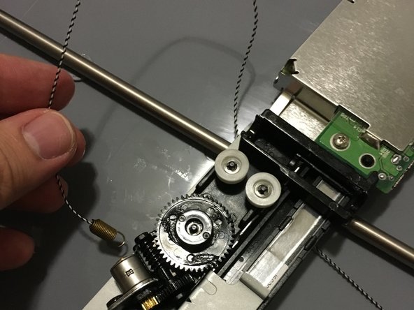

    6. Canon CanoScan N670U Sensor Bar Replacement: crwdns2935265:014crwdnd2935265:01crwdnd2935265:02crwdne2935265:0 Canon CanoScan N670U Sensor Bar Replacement: crwdns2935265:014crwdnd2935265:02crwdnd2935265:02crwdne2935265:0
      • Flip the sensor bar over and unwind the belt from the gear system.
    7. Canon CanoScan N670U Sensor Bar Replacement: crwdns2935265:015crwdnd2935265:01crwdnd2935265:01crwdne2935265:0
      • Remove the sensor bar from the scanner and replace it with the new one.
