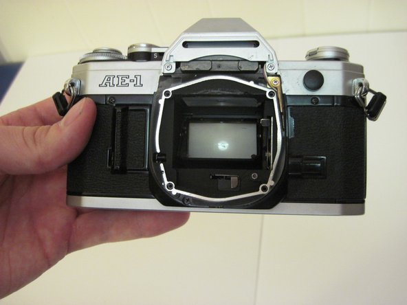

  4. Canon AE-1 SLR Lens Mount Replacement: crwdns2935265:04crwdnd2935265:01crwdnd2935265:01crwdne2935265:0
    • Remove the four #00 screws from the SLR lens mount using a Phillips #00 screwdriver.
  5. Canon AE-1 SLR Lens Mount Replacement: crwdns2935265:05crwdnd2935265:01crwdnd2935265:03crwdne2935265:0 Canon AE-1 SLR Lens Mount Replacement: crwdns2935265:05crwdnd2935265:02crwdnd2935265:03crwdne2935265:0 Canon AE-1 SLR Lens Mount Replacement: crwdns2935265:05crwdnd2935265:03crwdnd2935265:03crwdne2935265:0

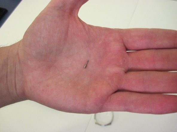

    • Pull the SLR lens mount away from the body of the camera.
    • Be aware that a pin will fall out when the SLR lens mount is removed.
