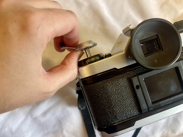

  1. Canon AE-1 Program Light Seal Replacement, Light Seals: crwdns2935265:01crwdnd2935265:01crwdnd2935265:02crwdne2935265:0 Canon AE-1 Program Light Seal Replacement, Light Seals: crwdns2935265:01crwdnd2935265:02crwdnd2935265:02crwdne2935265:0
    • Hold the camera with the back facing you, and gently pull up on the rewind knob located on the top-left side of the camera using your other hand.
    • This action will release the camera back.
    • Carefully open the back of the camera to reveal the film compartment.
    • Place the camera on a clean, stable surface to access the grooves more easily and work comfortably on removing the old seals.

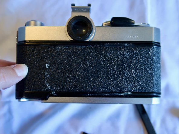

    • Inspect the edges of the camera back door, the hinge area, and the mirror damper (located near the shutter) for old or deteriorating seals.
    • Take note of where the seals need replacing.

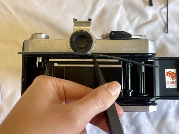

  3. Canon AE-1 Program Light Seal Replacement: crwdns2935265:03crwdnd2935265:01crwdnd2935265:02crwdne2935265:0 Canon AE-1 Program Light Seal Replacement: crwdns2935265:03crwdnd2935265:02crwdnd2935265:02crwdne2935265:0

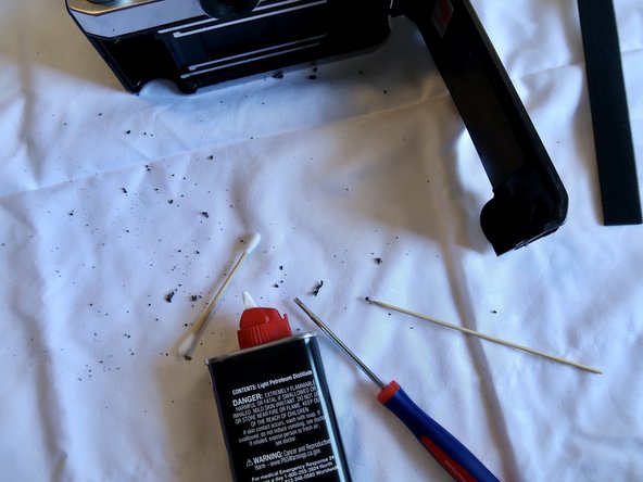

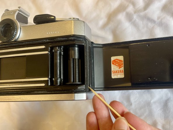

    • Use a toothpick or tweezers to carefully scrape out the old, degraded light seals.
    • Be careful not to damage the grooves or scratch the metal surfaces during removal.
  4. Canon AE-1 Program Light Seal Replacement: crwdns2935265:04crwdnd2935265:01crwdnd2935265:02crwdne2935265:0 Canon AE-1 Program Light Seal Replacement: crwdns2935265:04crwdnd2935265:02crwdnd2935265:02crwdne2935265:0
    • Soak a cotton swab in isopropyl alcohol (90% or higher) and gently clean out the grooves where the old seals were located.
    • This will remove any sticky residue and ensure a clean surface for the new seals.
    • Clear the work area of any remnants from the old light seal.

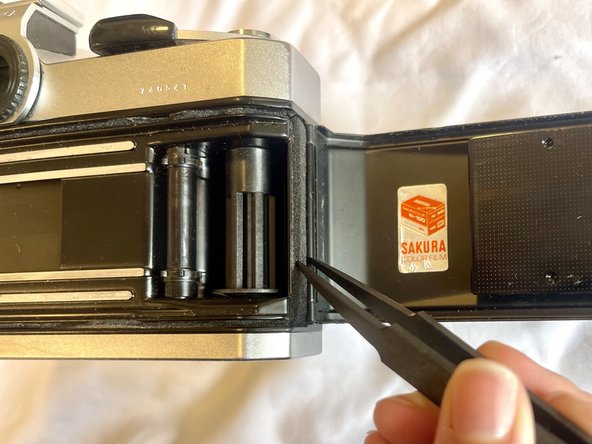

    • Use tweezers to carefully place the new light seals into the clean grooves.
    • Ensure the seals fit snugly in place without sticking out or causing obstruction to the camera’s closing mechanism.

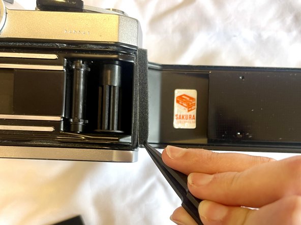

    • Gently press the new foam pieces into the spaces ensuring they fit flush within the space.
  8. Canon AE-1 Program Light Seal Replacement: crwdns2935265:08crwdnd2935265:01crwdnd2935265:03crwdne2935265:0 Canon AE-1 Program Light Seal Replacement: crwdns2935265:08crwdnd2935265:02crwdnd2935265:03crwdne2935265:0 Canon AE-1 Program Light Seal Replacement: crwdns2935265:08crwdnd2935265:03crwdnd2935265:03crwdne2935265:0
    • Carefully close the camera back and open it again to check for any gaps or misalignment.
    • Ensure the camera back closes securely without resistance and that the mirror damper is properly installed.
    • Your Canon AE-1 Program is now ready for a test roll to ensure there are no light leaks!
