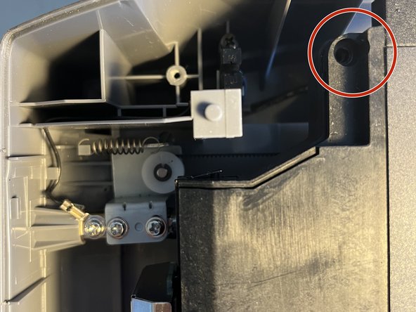

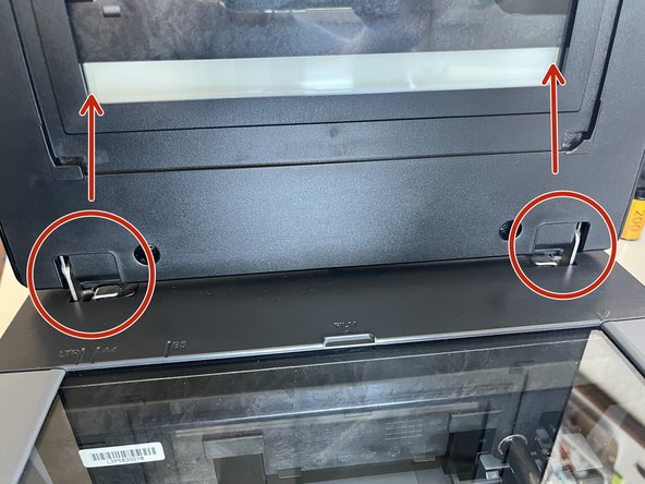

  2. Canon 9950F Scanner Teardown, Opening the top part: crwdns2935265:02crwdnd2935265:01crwdnd2935265:02crwdne2935265:0 Canon 9950F Scanner Teardown, Opening the top part: crwdns2935265:02crwdnd2935265:02crwdnd2935265:02crwdne2935265:0
    • Loosen the 6 screws.
    • There are also 3 clips at the top, you can undo them by sliding it a little in the direction of the hinges, then unclipping.
    • When you are moving the scanner parts of the machine, try to do so by moving the gear, as it is intended to avoid damage.
    • Don't forget to put the scanner back to it's original position after you are done cleaning.

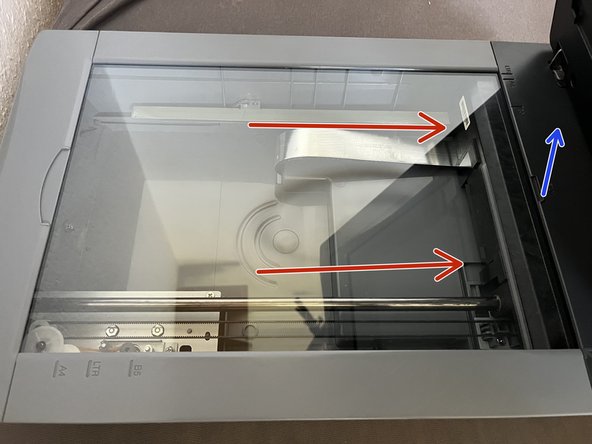

  3. Canon 9950F Scanner Teardown, Opening the bottom part: crwdns2935265:03crwdnd2935265:01crwdnd2935265:02crwdne2935265:0 Canon 9950F Scanner Teardown, Opening the bottom part: crwdns2935265:03crwdnd2935265:02crwdnd2935265:02crwdne2935265:0
    • From the two slots the hinges move out from, undo two phillips screws.
    • Then unclip the plastic cover, it has some clips at the back. Should come out relatively easy.
    • Slide the glass in the direction of the red arrows. Then lift the glass a little by blue arrow and it should come out.
    • Now you can clean the insides and back of the glass.

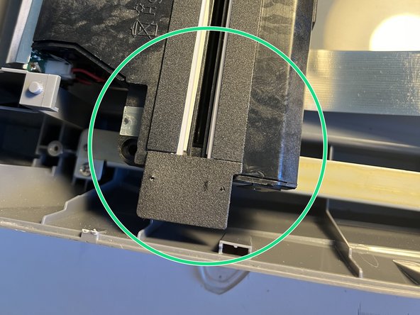

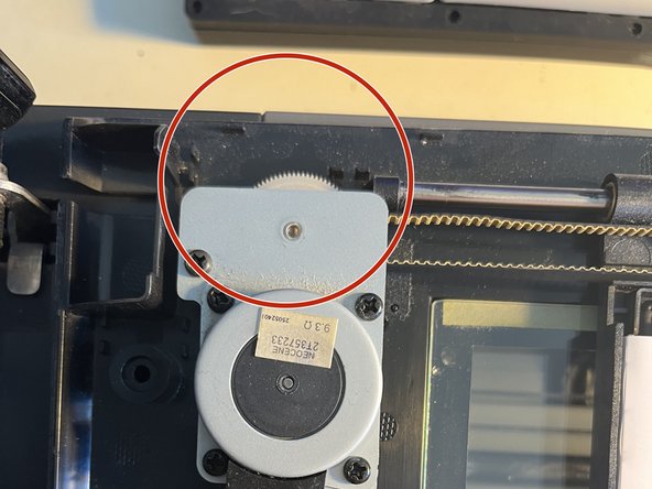

  4. Canon 9950F Scanner Teardown, Opening the scanner head for cleaning: crwdns2935265:04crwdnd2935265:01crwdnd2935265:03crwdne2935265:0 Canon 9950F Scanner Teardown, Opening the scanner head for cleaning: crwdns2935265:04crwdnd2935265:02crwdnd2935265:03crwdne2935265:0 Canon 9950F Scanner Teardown, Opening the scanner head for cleaning: crwdns2935265:04crwdnd2935265:03crwdnd2935265:03crwdne2935265:0
    • Move the scanner head a little away form its resting position. Again, by turning the gears.
    • Unscrew the the phillips screws at the sides of the head.
    • The head also has about 6 metal clips in total in the two sides. You have to undo 2 to open it for sure. But I undid all, just to be sure.
    • The part shown with the green circle, needed some fiddling to also undo. There are wires here, so pay attention not to damage anything! I just moved it off to the side while cleaning the mirrors.
