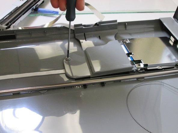

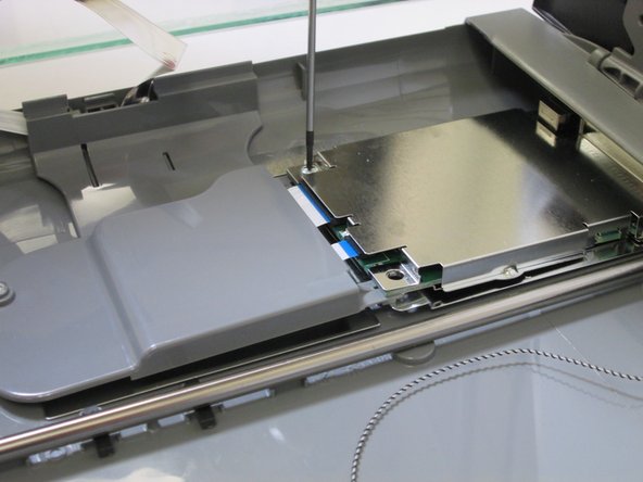

  4. CanoScan LiDE 35 Square Port Removal, Square Port: crwdns2935265:04crwdnd2935265:01crwdnd2935265:03crwdne2935265:0 CanoScan LiDE 35 Square Port Removal, Square Port: crwdns2935265:04crwdnd2935265:02crwdnd2935265:03crwdne2935265:0 CanoScan LiDE 35 Square Port Removal, Square Port: crwdns2935265:04crwdnd2935265:03crwdnd2935265:03crwdne2935265:0
    • Locate three screws on the grey shell.
    • Unscrew the three screws.
    • Separate the grey shell from case.
  5. CanoScan LiDE 35 Square Port Removal: crwdns2935265:05crwdnd2935265:01crwdnd2935265:03crwdne2935265:0 CanoScan LiDE 35 Square Port Removal: crwdns2935265:05crwdnd2935265:02crwdnd2935265:03crwdne2935265:0 CanoScan LiDE 35 Square Port Removal: crwdns2935265:05crwdnd2935265:03crwdnd2935265:03crwdne2935265:0
    • Separate the grey shell from square port.
