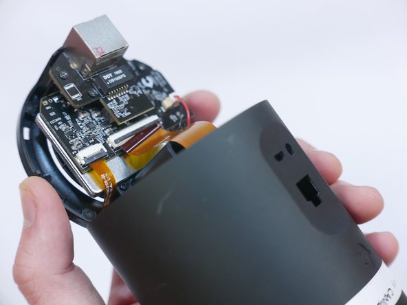

  4. Canary CAN100USBK Infrared Blocking Filter Replacement: crwdns2935265:04crwdnd2935265:01crwdnd2935265:02crwdne2935265:0 Canary CAN100USBK Infrared Blocking Filter Replacement: crwdns2935265:04crwdnd2935265:02crwdnd2935265:02crwdne2935265:0
    • Do not yank the bottom off or you may damage the ribbon cable or the ZIF connector.
    • Carefully remove the bottom casing by gripping it on both sides and pulling straight up.
  5. Canary CAN100USBK Infrared Blocking Filter Replacement: crwdns2935265:05crwdnd2935265:01crwdnd2935265:02crwdne2935265:0 Canary CAN100USBK Infrared Blocking Filter Replacement: crwdns2935265:05crwdnd2935265:02crwdnd2935265:02crwdne2935265:0
    • Use the pointed end of the spudger to flip up the small retaining flap on the ZIF (zero insertion force) connector.
    • Pull the ribbon cable out towards the device.

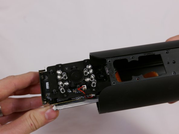

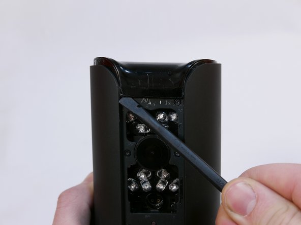

  6. Canary CAN100USBK Infrared Blocking Filter Replacement, Front Panel: crwdns2935265:06crwdnd2935265:01crwdnd2935265:02crwdne2935265:0 Canary CAN100USBK Infrared Blocking Filter Replacement, Front Panel: crwdns2935265:06crwdnd2935265:02crwdnd2935265:02crwdne2935265:0
    • There are two empty nooks underneath the bottom of the panel close to each side of the case.
    • Place the pointed edge of the spudger in one of the nooks under the panel and pry upwards.
  7. Canary CAN100USBK Infrared Blocking Filter Replacement: crwdns2935265:07crwdnd2935265:01crwdnd2935265:01crwdne2935265:0
    • Adhesive will have to be reapplied after removing the panel.
    • Pull the panel away from the device.

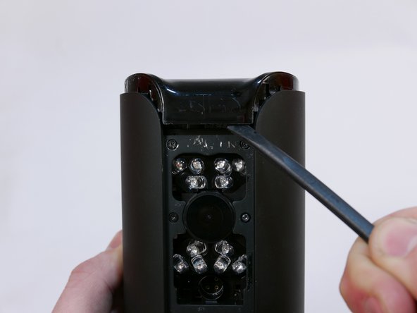

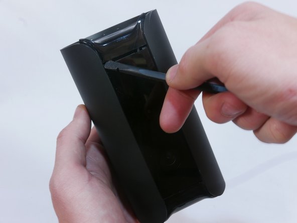

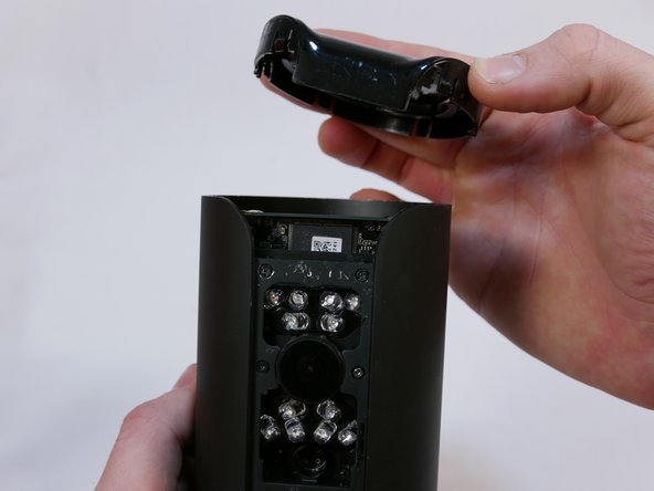

  8. Canary CAN100USBK Infrared Blocking Filter Replacement, Top Casing: crwdns2935265:08crwdnd2935265:01crwdnd2935265:03crwdne2935265:0 Canary CAN100USBK Infrared Blocking Filter Replacement, Top Casing: crwdns2935265:08crwdnd2935265:02crwdnd2935265:03crwdne2935265:0 Canary CAN100USBK Infrared Blocking Filter Replacement, Top Casing: crwdns2935265:08crwdnd2935265:03crwdnd2935265:03crwdne2935265:0
    • Use the flat end of the spudger to carefully pry off the top casing.
    • Alternate pushing up on the left and right sides until the inner clips are released.
    • Do not use too much force or the top may fly off unexpectedly.
  9. Canary CAN100USBK Infrared Blocking Filter Replacement: crwdns2935265:09crwdnd2935265:01crwdnd2935265:02crwdne2935265:0 Canary CAN100USBK Infrared Blocking Filter Replacement: crwdns2935265:09crwdnd2935265:02crwdnd2935265:02crwdne2935265:0
    • Pull the top casing away from the device.

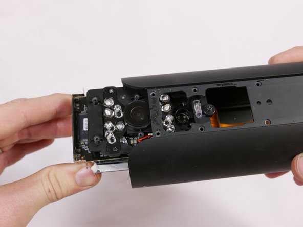

  12. Canary CAN100USBK Infrared Blocking Filter Replacement: crwdns2935265:012crwdnd2935265:01crwdnd2935265:03crwdne2935265:0 Canary CAN100USBK Infrared Blocking Filter Replacement: crwdns2935265:012crwdnd2935265:02crwdnd2935265:03crwdne2935265:0 Canary CAN100USBK Infrared Blocking Filter Replacement: crwdns2935265:012crwdnd2935265:03crwdnd2935265:03crwdne2935265:0
    • Grip the circular part of the motherboard and pull it straight out of the device.
  13. Canary CAN100USBK Infrared Blocking Filter Replacement: crwdns2935265:013crwdnd2935265:01crwdnd2935265:02crwdne2935265:0 Canary CAN100USBK Infrared Blocking Filter Replacement: crwdns2935265:013crwdnd2935265:02crwdnd2935265:02crwdne2935265:0

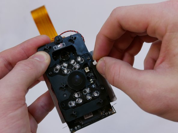

    • Locate the power connector next to the lens protector on the infrared LED board. Using your fingers, wiggle the power connector back and forth until it is loose.

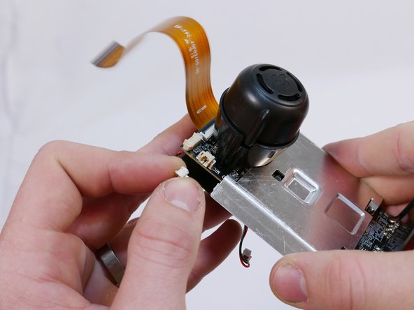

  14. Canary CAN100USBK Infrared Blocking Filter Replacement: crwdns2935265:014crwdnd2935265:01crwdnd2935265:02crwdne2935265:0 Canary CAN100USBK Infrared Blocking Filter Replacement: crwdns2935265:014crwdnd2935265:02crwdnd2935265:02crwdne2935265:0
    • Find the power connector next to the buzzer that is labelled "MIC IR-LED". Use your fingers to wiggle it back and forth until it becomes loose.

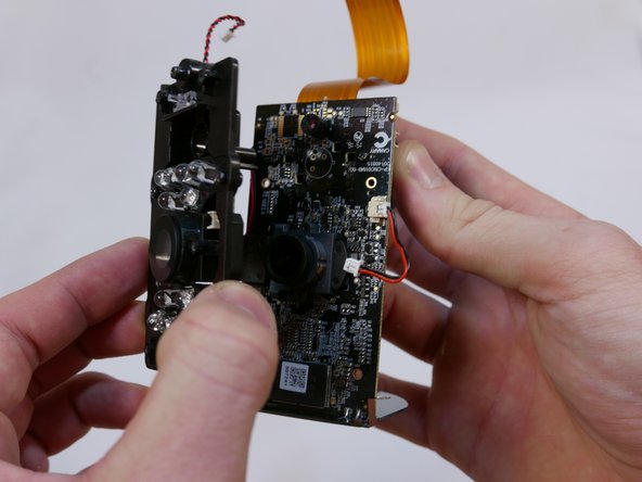

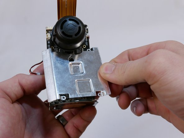

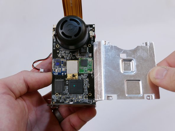

  15. Canary CAN100USBK Infrared Blocking Filter Replacement: crwdns2935265:015crwdnd2935265:01crwdnd2935265:03crwdne2935265:0 Canary CAN100USBK Infrared Blocking Filter Replacement: crwdns2935265:015crwdnd2935265:02crwdnd2935265:03crwdne2935265:0 Canary CAN100USBK Infrared Blocking Filter Replacement: crwdns2935265:015crwdnd2935265:03crwdnd2935265:03crwdne2935265:0
    • Remove the four Phillips #0 6mm screws.
    • Lift the heatsink up and pull it away from the motherboard.
    • These screws also hold the infrared LED board in. Be sure to hold it while you remove the heatsink screws.

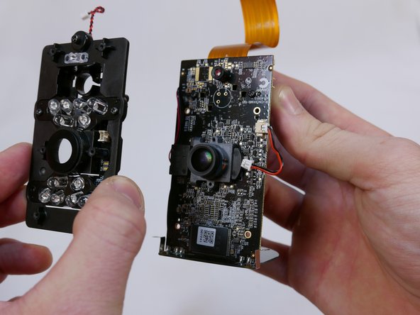

  16. Canary CAN100USBK Infrared Blocking Filter Replacement: crwdns2935265:016crwdnd2935265:01crwdnd2935265:03crwdne2935265:0 Canary CAN100USBK Infrared Blocking Filter Replacement: crwdns2935265:016crwdnd2935265:02crwdnd2935265:03crwdne2935265:0 Canary CAN100USBK Infrared Blocking Filter Replacement: crwdns2935265:016crwdnd2935265:03crwdnd2935265:03crwdne2935265:0
    • Lift the infrared LED board directly upwards and pull away from the motherboard.

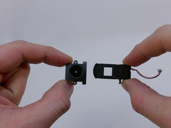

    • Using your forefinger and thumb, grip the top and bottom of the lens assembly and pull away from the motherboard.

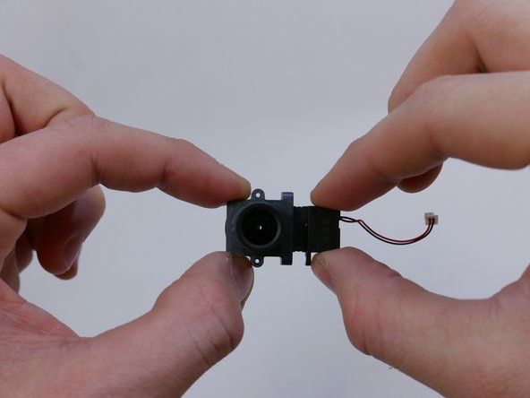

  19. Canary CAN100USBK Infrared Blocking Filter Replacement, Infrared Blocking Filter: crwdns2935265:019crwdnd2935265:01crwdnd2935265:01crwdne2935265:0
    • Remove the Phillips #0 5mm screw.
    • The lens holder has two screw holes but the filter unit is held in with one screw. You are not missing a screw.
  20. Canary CAN100USBK Infrared Blocking Filter Replacement: crwdns2935265:020crwdnd2935265:01crwdnd2935265:03crwdne2935265:0 Canary CAN100USBK Infrared Blocking Filter Replacement: crwdns2935265:020crwdnd2935265:02crwdnd2935265:03crwdne2935265:0 Canary CAN100USBK Infrared Blocking Filter Replacement: crwdns2935265:020crwdnd2935265:03crwdnd2935265:03crwdne2935265:0
    • Grab the battery end of the filter and pull to slide it out.
