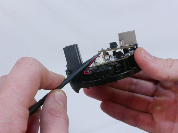

  6. Canary CAN100USBK Audio and USB PCB Board Replacement, Ethernet PCB Board: crwdns2935265:06crwdnd2935265:01crwdnd2935265:01crwdne2935265:0
    • Use your Phillips #0 screwdriver to remove the three 5mm screws.
  7. Canary CAN100USBK Audio and USB PCB Board Replacement: crwdns2935265:07crwdnd2935265:01crwdnd2935265:02crwdne2935265:0 Canary CAN100USBK Audio and USB PCB Board Replacement: crwdns2935265:07crwdnd2935265:02crwdnd2935265:02crwdne2935265:0
    • Place the flat end of the spudger underneath the Ethernet PCB board and slowly pry up until it's loose.
  8. Canary CAN100USBK Audio and USB PCB Board Replacement: crwdns2935265:08crwdnd2935265:01crwdnd2935265:01crwdne2935265:0
    • Carefully pull the Ethernet PCB board away from the board that sits underneath.

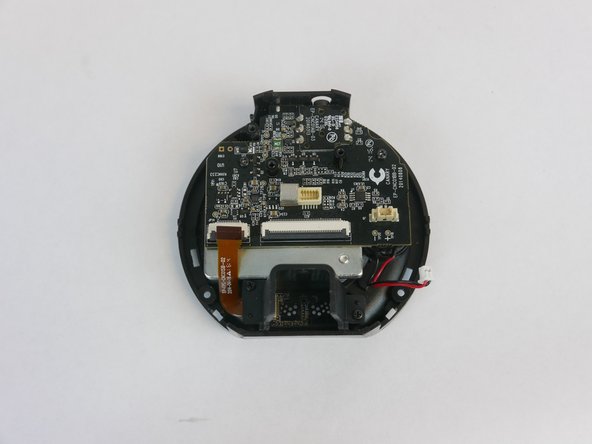

  9. Canary CAN100USBK Audio and USB PCB Board Replacement, Audio and USB PCB Board: crwdns2935265:09crwdnd2935265:01crwdnd2935265:01crwdne2935265:0
    • Using your fingernails, wiggle the power connector back and forth until it becomes loose.
    • Pull the power connector straight out of the socket.
    • Pull only on the power connector and not the wires themselves to prevent damage.

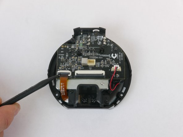

  10. Canary CAN100USBK Audio and USB PCB Board Replacement: crwdns2935265:010crwdnd2935265:01crwdnd2935265:03crwdne2935265:0 Canary CAN100USBK Audio and USB PCB Board Replacement: crwdns2935265:010crwdnd2935265:02crwdnd2935265:03crwdne2935265:0 Canary CAN100USBK Audio and USB PCB Board Replacement: crwdns2935265:010crwdnd2935265:03crwdnd2935265:03crwdne2935265:0
    • Use the spudger to pry up the retaining flap of the ZIF connector.
    • Disconnect the ribbon cable.

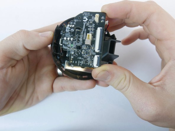

  11. Canary CAN100USBK Audio and USB PCB Board Replacement: crwdns2935265:011crwdnd2935265:01crwdnd2935265:01crwdne2935265:0
    • Remove the two Phillips #0 5mm screws.
  12. Canary CAN100USBK Audio and USB PCB Board Replacement: crwdns2935265:012crwdnd2935265:01crwdnd2935265:02crwdne2935265:0 Canary CAN100USBK Audio and USB PCB Board Replacement: crwdns2935265:012crwdnd2935265:02crwdnd2935265:02crwdne2935265:0
    • Pull the board away from the bottom casing by lifting the end closest to the chimney up.
