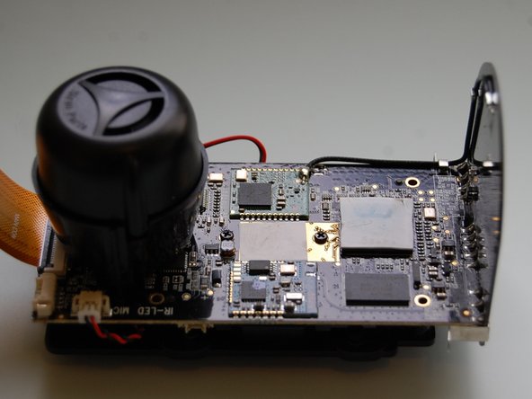

      • The inside is dominated by a aluminum plate with dimples for the Ambarella A5S CPU and the back of the image sensor. The heat sink presses against the outer case, through a squishy thermal interface material (TIM).
      • The huge round thing is a buzzer. The round PCB board hosts the 2.4Ghz WiFi and bluetooth antennas (there is no 5Ghz).

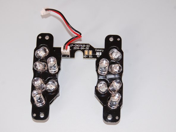

      • The infrared LED board sports a plastic frame to aim each LED separately.

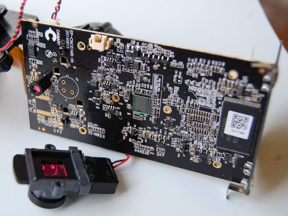

    4. Canary  Connect (Home Internet Security Camera), What's Behind the Lens?: crwdns2935265:04crwdnd2935265:01crwdnd2935265:02crwdne2935265:0 Canary  Connect (Home Internet Security Camera), What's Behind the Lens?: crwdns2935265:04crwdnd2935265:02crwdnd2935265:02crwdne2935265:0
      • Canary achieves its flat lens front with an extra sheet of glass that's not optically active. Buried inside is a conventionally shaped M12 security lens.
      • A switchable IR blocking filter is included for day/night mode. This blocks IR light during the day, but switches to be transparent at night.
      • The lens holder is unremarkable. Components are placed within the light chamber to allow the back to support the heat sink.
      • Note the empty holes for... some sort of sensor, not stuffed. Maybe air quality?
      • That's it. I hope you've enjoyed this tour into the insides of Canary.
