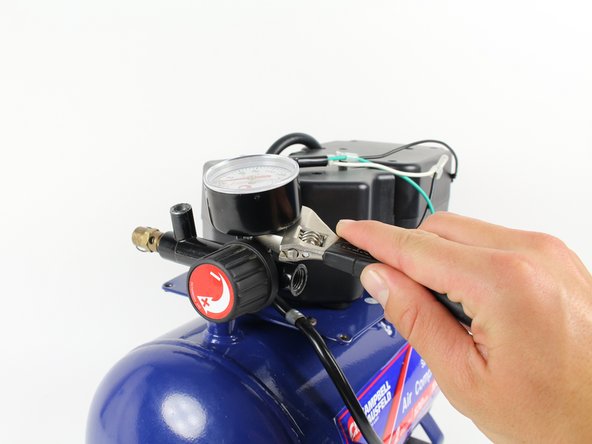

  5. Campbell Hausfeld FP204800 Pressure Gauge Replacement, Remove the pressure gauges: crwdns2935265:05crwdnd2935265:01crwdnd2935265:02crwdne2935265:0 Campbell Hausfeld FP204800 Pressure Gauge Replacement, Remove the pressure gauges: crwdns2935265:05crwdnd2935265:02crwdnd2935265:02crwdne2935265:0
    • Using a Smart Wrench, remove the old/broken pressure gauge or gauges.
