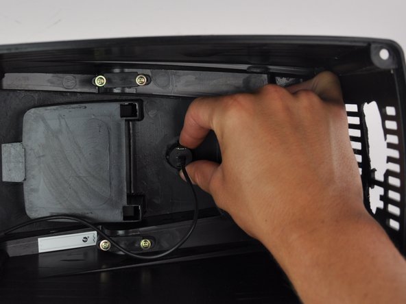

  5. Campbell Hausfeld FP204800 On/Off Switch Replacement, Configure the on/off switch for removal: crwdns2935265:05crwdnd2935265:01crwdnd2935265:02crwdne2935265:0 Campbell Hausfeld FP204800 On/Off Switch Replacement, Configure the on/off switch for removal: crwdns2935265:05crwdnd2935265:02crwdnd2935265:02crwdne2935265:0
    • Twist the On/Off switch from the underside of the shroud.
    • Twist 90 degrees in any direction or until the on/off switch prongs are in a vertical position.
    • When the switch has reached the correct position, you will feel it "click" into place.
  6. Campbell Hausfeld FP204800 On/Off Switch Replacement, Remove the on/off switch: crwdns2935265:06crwdnd2935265:01crwdnd2935265:01crwdne2935265:0
    • Push the on/off switch from the underside of the shroud until it comes loose.
    • If the switch is not in the correct position highlighted in the previous step, it will not be easily removed and could damage the shroud.
