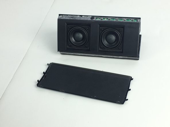

    • Remove the six screw covers from the bottom of the device.
  2. Cambridge SoundWorks OontZ Angle Plus Speaker Grill Replacement: crwdns2935265:02crwdnd2935265:01crwdnd2935265:01crwdne2935265:0
    • Starting from the screw covers, remove the front and back casing of the device.
  3. Cambridge SoundWorks OontZ Angle Plus Speaker Grill Replacement: crwdns2935265:03crwdnd2935265:01crwdnd2935265:01crwdne2935265:0
    • Carefully pull off the casing covering the ends.
  4. Cambridge SoundWorks OontZ Angle Plus Speaker Grill Replacement: crwdns2935265:04crwdnd2935265:01crwdnd2935265:01crwdne2935265:0
    • Slowly remove the casing from the top of the device.
  5. Cambridge SoundWorks OontZ Angle Plus Speaker Grill Replacement, Speaker Grill: crwdns2935265:05crwdnd2935265:01crwdnd2935265:01crwdne2935265:0
    • Unscrew the five 11.5mm Phillips screws from the bottom plate.
  6. Cambridge SoundWorks OontZ Angle Plus Speaker Grill Replacement: crwdns2935265:06crwdnd2935265:01crwdnd2935265:01crwdne2935265:0
    • Carefully pull apart the bottom and top plates, using the blue plastic opening tool.
  7. Cambridge SoundWorks OontZ Angle Plus Speaker Grill Replacement: crwdns2935265:07crwdnd2935265:01crwdnd2935265:01crwdne2935265:0
    • Once the plates are separated, slowly pull the bottom plate away from the top plate.
    • There are wires connected to both plates, so be cautious while doing this step.
  8. Cambridge SoundWorks OontZ Angle Plus Speaker Grill Replacement: crwdns2935265:08crwdnd2935265:01crwdnd2935265:01crwdne2935265:0
    • Use the metal spudger to bend the three bendable clamps on the ends of the speaker cover.
    • Beware, the bending process requires patience and extra time.
  9. Cambridge SoundWorks OontZ Angle Plus Speaker Grill Replacement: crwdns2935265:09crwdnd2935265:01crwdnd2935265:01crwdne2935265:0
    • Next, use the metal spudger to bend the four bendable clamps on the bottom of the speaker cover.
    • This step also requires some time and patience.
  10. Cambridge SoundWorks OontZ Angle Plus Speaker Grill Replacement: crwdns2935265:010crwdnd2935265:01crwdnd2935265:02crwdne2935265:0 Cambridge SoundWorks OontZ Angle Plus Speaker Grill Replacement: crwdns2935265:010crwdnd2935265:02crwdnd2935265:02crwdne2935265:0
    • Finally, bend the speaker cover upward and it will slide out.
