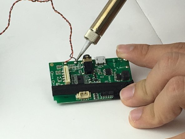

    8. Cambridge SoundWorks OontZ Angle Plus Motherboard  Replacement: crwdns2935265:09crwdnd2935265:01crwdnd2935265:01crwdne2935265:0
      • Desolder the wires that connect the battery to the motherboard, negative (black wire) and positive (red wire).
    1. Cambridge SoundWorks OontZ Angle Plus Motherboard  Replacement, Motherboard: crwdns2935265:010crwdnd2935265:01crwdnd2935265:01crwdne2935265:0
      • Unplug the wires that connect the speakers to the motherboard.
    2. Cambridge SoundWorks OontZ Angle Plus Motherboard  Replacement: crwdns2935265:011crwdnd2935265:01crwdnd2935265:01crwdne2935265:0
      • Unplug the thin white cable connected to the buttons.
    3. Cambridge SoundWorks OontZ Angle Plus Motherboard  Replacement: crwdns2935265:012crwdnd2935265:01crwdnd2935265:02crwdne2935265:0 Cambridge SoundWorks OontZ Angle Plus Motherboard  Replacement: crwdns2935265:012crwdnd2935265:02crwdnd2935265:02crwdne2935265:0
      • Desolder the wires that connect the LED to the motherboard.
