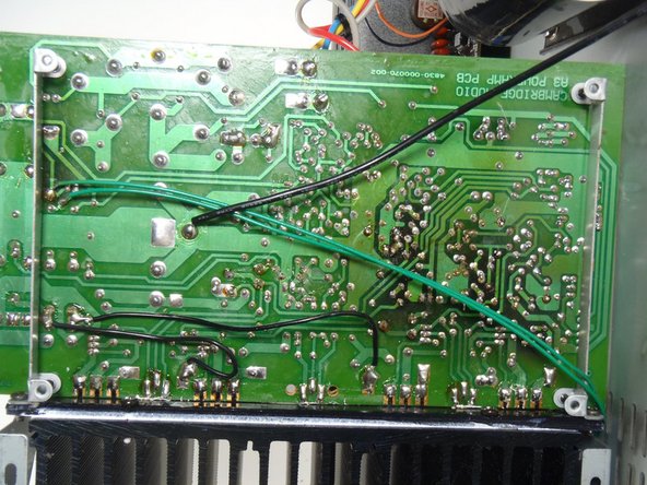

  5. Cambridge Audio A3i Motherboard Replacement, Motherboard: crwdns2935265:05crwdnd2935265:01crwdnd2935265:01crwdne2935265:0
    • Remove 2 screws from each side of the heatsink. These must be accessed from directly above the device.
    • Remove the green grounding wire from the mounting screw.
  6. Cambridge Audio A3i Motherboard Replacement: crwdns2935265:06crwdnd2935265:01crwdnd2935265:01crwdne2935265:0
    • With the amplifier on it's side, remove the 4 screws that hold the motherboard frame to the main case.
    • Be sure to hold the motherboard with one hand while removing the mount screws.
  7. Cambridge Audio A3i Motherboard Replacement: crwdns2935265:07crwdnd2935265:01crwdnd2935265:02crwdne2935265:0 Cambridge Audio A3i Motherboard Replacement: crwdns2935265:07crwdnd2935265:02crwdnd2935265:02crwdne2935265:0
    • Unscrew ground wire from main case.
    • De solder 4 wires coming from transformer.
    • The motherboard can now be lifted from the case. Any part that needs to be removed from it can be de-soldered.
