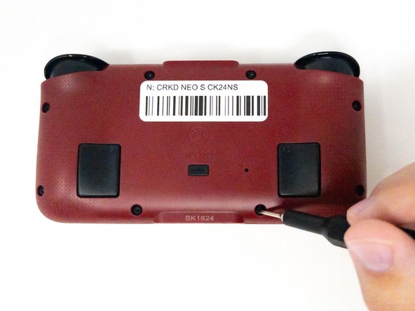

    • Turn the CRKD NEO S CK24NS upside down with the front-facing buttons facing downward.

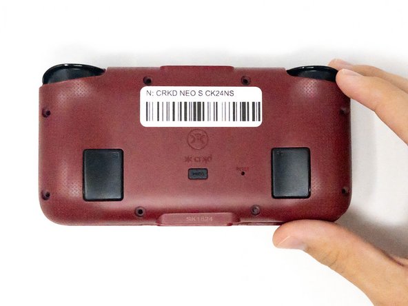

    • Use a 1.5 mm Hex screwdriver to remove the eight 1.5 mm Hex screws from the back of the controller.
    • Carefully lift off the back panel and set it aside.

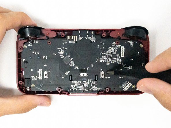

    • Remove the four 2.5 mm screws holding the motherboard in place using a Phillips #0 screwdriver.

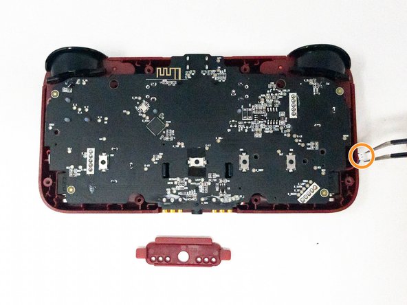

    • Take out the white plastic pieces connected to the motherboard with tweezers.
    • Gently lift the motherboard and set it aside.
    • If the small red plastic piece next to the audio jack falls out, don’t worry. You can pop it back into place during reassembly.

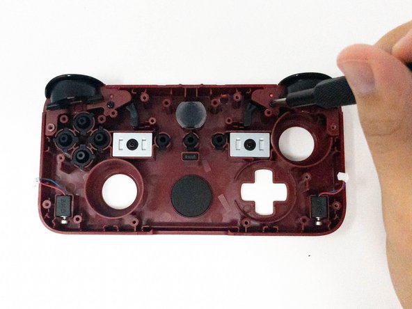

    • Remove the two 2.5 mm Phillips #0 screws and keep them for reassembly.
    • The screws for the left trigger will be on the right.
    • The screws for the right trigger will be on the left.

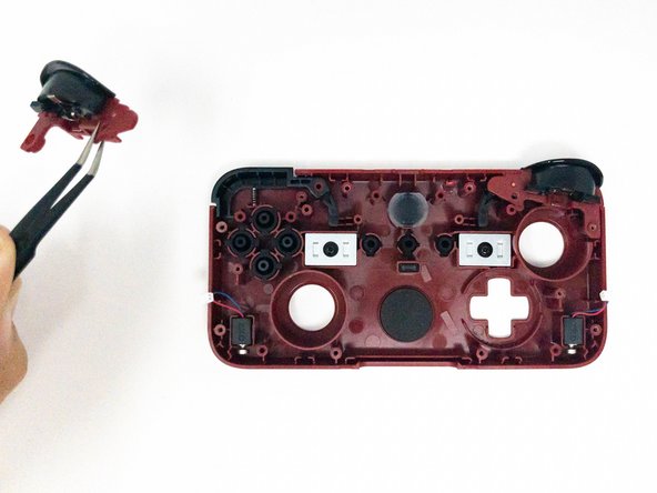

    • Using tweezers, carefully remove the ZL and/or ZR trigger pieces.
    • Insert the new trigger(s) in the same position.
