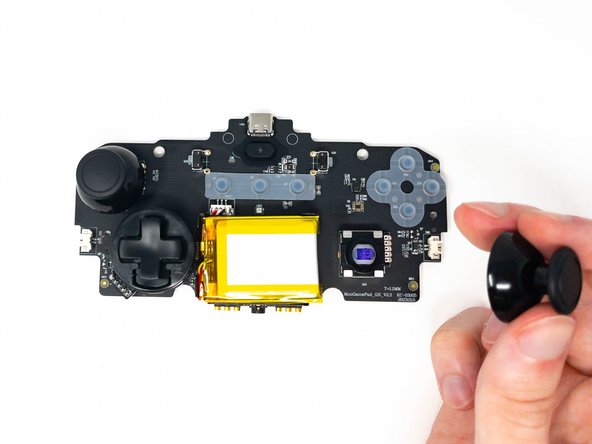

    • Turn the CRKD NEO S CK24NS upside down with the front-facing buttons facing downward.
  2. CRKD NEO S CK24NS Thumbstick Cap Replacement: crwdns2935265:02crwdnd2935265:01crwdnd2935265:03crwdne2935265:0 CRKD NEO S CK24NS Thumbstick Cap Replacement: crwdns2935265:02crwdnd2935265:02crwdnd2935265:03crwdne2935265:0 CRKD NEO S CK24NS Thumbstick Cap Replacement: crwdns2935265:02crwdnd2935265:03crwdnd2935265:03crwdne2935265:0
    • Use a 1.5 mm Hex screwdriver to remove the eight 1.5 mm Hex screws from the back of the controller.
    • Carefully lift off the back panel and set it aside.
  3. CRKD NEO S CK24NS Thumbstick Cap Replacement: crwdns2935265:03crwdnd2935265:01crwdnd2935265:03crwdne2935265:0 CRKD NEO S CK24NS Thumbstick Cap Replacement: crwdns2935265:03crwdnd2935265:02crwdnd2935265:03crwdne2935265:0 CRKD NEO S CK24NS Thumbstick Cap Replacement: crwdns2935265:03crwdnd2935265:03crwdnd2935265:03crwdne2935265:0
    • Remove the four 2.5 mm screws holding the motherboard in place using a Phillips #0 screwdriver.
    • Take out the white plastic pieces connected to the motherboard with tweezers.
    • Gently lift the motherboard and set it aside.
    • If the small red plastic piece next to the audio jack falls out, don’t worry. You can pop it back into place during reassembly.

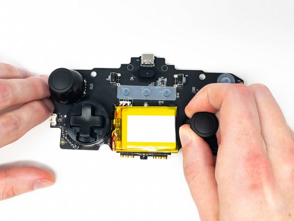

  4. CRKD NEO S CK24NS Thumbstick Cap Replacement, Thumbstick Cap: crwdns2935265:04crwdnd2935265:01crwdnd2935265:03crwdne2935265:0 CRKD NEO S CK24NS Thumbstick Cap Replacement, Thumbstick Cap: crwdns2935265:04crwdnd2935265:02crwdnd2935265:03crwdne2935265:0 CRKD NEO S CK24NS Thumbstick Cap Replacement, Thumbstick Cap: crwdns2935265:04crwdnd2935265:03crwdnd2935265:03crwdne2935265:0
    • Flip the motherboard right-side up.
    • Gently pull off the thumbstick caps.
