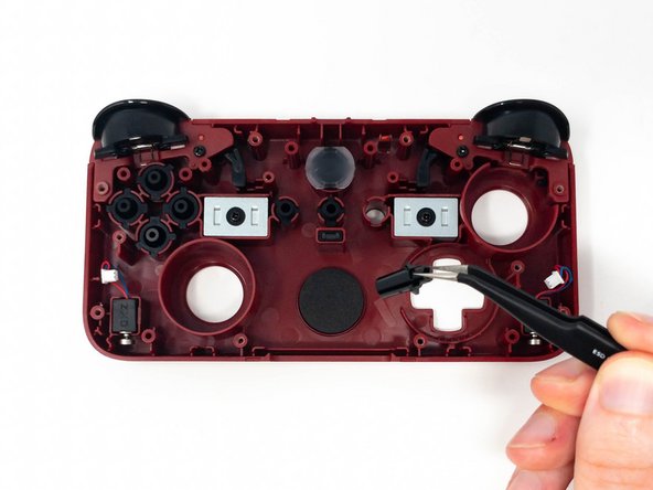

  4. CRKD NEO S CK24NS Button Replacement, Button: crwdns2935265:04crwdnd2935265:01crwdnd2935265:02crwdne2935265:0 CRKD NEO S CK24NS Button Replacement, Button: crwdns2935265:04crwdnd2935265:02crwdnd2935265:02crwdne2935265:0
    • Depending on the button(s) you want to replace, lift them out with a pair of tweezers and put the new buttons in.
    • Make sure the controller is facedown because the buttons will fall out.
