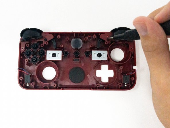

  4. CRKD NEO S CK24NS Bumper and Spring Replacement, Bumper and Spring: crwdns2935265:04crwdnd2935265:01crwdnd2935265:02crwdne2935265:0 CRKD NEO S CK24NS Bumper and Spring Replacement, Bumper and Spring: crwdns2935265:04crwdnd2935265:02crwdnd2935265:02crwdne2935265:0
    • Remove the two 2.5 mm Phillips #0 screws and keep them for reassembly.
    • The screw for the the left trigger will be on the right.
    • The screw for the right trigger will be on the left.

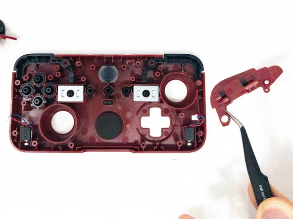

  5. CRKD NEO S CK24NS Bumper and Spring Replacement: crwdns2935265:05crwdnd2935265:01crwdnd2935265:02crwdne2935265:0 CRKD NEO S CK24NS Bumper and Spring Replacement: crwdns2935265:05crwdnd2935265:02crwdnd2935265:02crwdne2935265:0
    • Using tweezers, carefully remove the ZL and/or ZR trigger pieces.

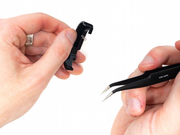

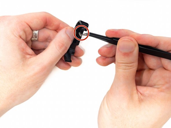

  6. CRKD NEO S CK24NS Bumper and Spring Replacement: crwdns2935265:06crwdnd2935265:01crwdnd2935265:03crwdne2935265:0 CRKD NEO S CK24NS Bumper and Spring Replacement: crwdns2935265:06crwdnd2935265:02crwdnd2935265:03crwdne2935265:0 CRKD NEO S CK24NS Bumper and Spring Replacement: crwdns2935265:06crwdnd2935265:03crwdnd2935265:03crwdne2935265:0
    • Pull out the bumper(s) with tweezers
    • Place the new spring inside.
    • When you pull the bumper out of the controller, the spring inside will release and pop out quickly. This is completely normal, so don’t be alarmed! To keep track of all parts, hold the bumper firmly and perform this step over a flat, open surface.
