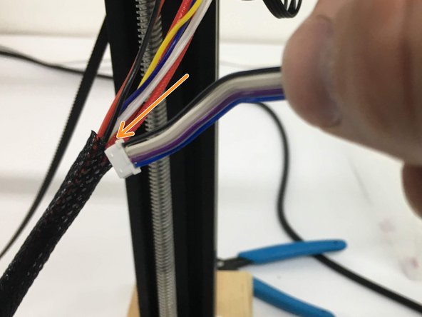

    3. CR-10S Pro BL Touch Install, Top Section 1c.: crwdns2935265:03crwdnd2935265:01crwdnd2935265:03crwdne2935265:0 CR-10S Pro BL Touch Install, Top Section 1c.: crwdns2935265:03crwdnd2935265:02crwdnd2935265:03crwdne2935265:0 CR-10S Pro BL Touch Install, Top Section 1c.: crwdns2935265:03crwdnd2935265:03crwdnd2935265:03crwdne2935265:0
      • Cut 2 zip ties.
      • Remove 3 button head screws using M2 hex to remove the daughterboard cover.
      • Unplug the original probe connector. It may have glue on it so pull on the connector, not the wires.
      • Daughterboard is marked with pink arrows.
      • No jumper needed for this install. We will not be using Z- port so these instructions are specific to using our firmware!

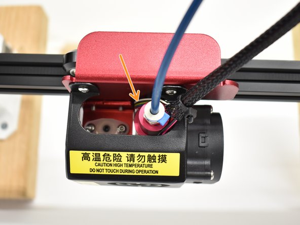

    4. CR-10S Pro BL Touch Install, Top Section 1d./ 2a.: crwdns2935265:04crwdnd2935265:01crwdnd2935265:03crwdne2935265:0 CR-10S Pro BL Touch Install, Top Section 1d./ 2a.: crwdns2935265:04crwdnd2935265:02crwdnd2935265:03crwdne2935265:0 CR-10S Pro BL Touch Install, Top Section 1d./ 2a.: crwdns2935265:04crwdnd2935265:03crwdnd2935265:03crwdne2935265:0
      • Pull the expandable loom back towards the daughterboard. This will shorten and expand it, making it easy for the next couple steps
      • Pull the original probe out from the opposite side to remove it from the loom.
      • From the daughterboard side, insert the new probe harness with the small plug (probe side) going in first. With the loom still expanded, you should be able to get it completely through.
      • Leave about 1-1.5 inches of the tail end of the probe harness exposed next to the ribbon cable connection and reattach the daughterboard cover.

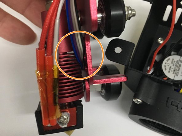

    5. CR-10S Pro BL Touch Install, Top Section 2b.: crwdns2935265:05crwdnd2935265:01crwdnd2935265:03crwdne2935265:0 CR-10S Pro BL Touch Install, Top Section 2b.: crwdns2935265:05crwdnd2935265:02crwdnd2935265:03crwdne2935265:0 CR-10S Pro BL Touch Install, Top Section 2b.: crwdns2935265:05crwdnd2935265:03crwdnd2935265:03crwdne2935265:0
      • Tighten button head screws with M2 hex. Start with the top 2 then position the bottom tab, aligning the holes to install the 3rd screw.
      • Add new zip ties to hold the cable loom in place.
      • On the hot end/probe side, route the wires behind the hot end and plug into the probe.
      • Be sure that the probe wires are not pinched between the X carriage and probe mounting bracket.
      • Install and tighten the button head screws.

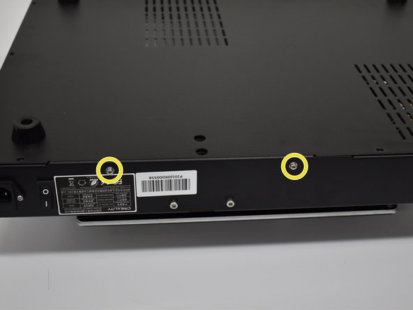

    7. CR-10S Pro BL Touch Install, Bottom Section 1a.: crwdns2935265:07crwdnd2935265:01crwdnd2935265:03crwdne2935265:0 CR-10S Pro BL Touch Install, Bottom Section 1a.: crwdns2935265:07crwdnd2935265:02crwdnd2935265:03crwdne2935265:0 CR-10S Pro BL Touch Install, Bottom Section 1a.: crwdns2935265:07crwdnd2935265:03crwdnd2935265:03crwdne2935265:0
      • Using a #1 Phillips screwdriver, remove the 11 screws on the bottom and 2 screws on each side for a total of 15. Next, remove the bottom cover.
      • Unplug the original ribbon cable (not shown)
      • Plug in new connections. For clarity, we only have the new connections shown here.
      • Ribbon Cable (keyed)
      • 3 pin black plug into D11 (end row towards SD card slot) Orange wire will face the ribbon cable like in the picture.
      • 2 pin white plug into Z+ (connection closest to the ribbon cable) From the same view as the picture, use the right 2 pins.
      • Hot glue is optional.

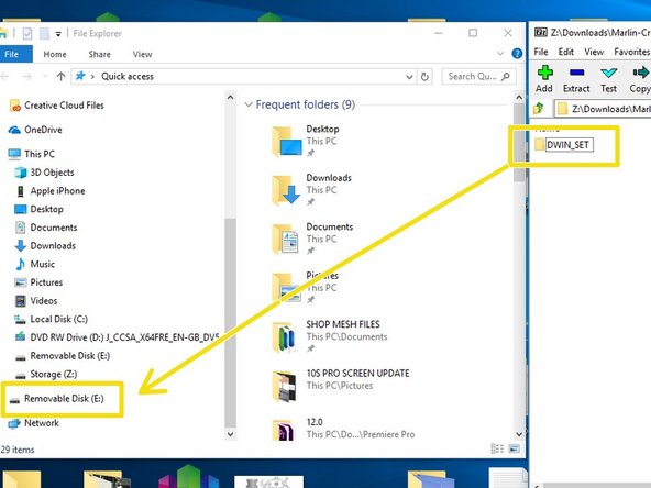

    8. CR-10S Pro BL Touch Install, Prepare the SD card: crwdns2935265:08crwdnd2935265:01crwdnd2935265:02crwdne2935265:0 CR-10S Pro BL Touch Install, Prepare the SD card: crwdns2935265:08crwdnd2935265:02crwdnd2935265:02crwdne2935265:0
      • Locate a micro SD card no bigger than 16gb in capacity and format it to FAT 32 / Default allocation size.
      • It is critical to set the Allocation unit size to "Default..." or 4096.
      • Download the Screen Files, unzip and locate the directory called "DWIN_SET." These files are also linked in Step 12.
      • Copy/Paste, drag or right click and send DWIN_SET to the formatted SD card.

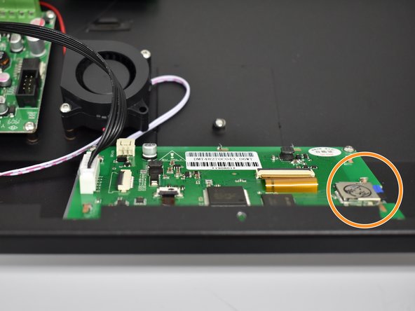

    9. CR-10S Pro BL Touch Install, Flash the Screen Files: crwdns2935265:09crwdnd2935265:01crwdnd2935265:03crwdne2935265:0 CR-10S Pro BL Touch Install, Flash the Screen Files: crwdns2935265:09crwdnd2935265:02crwdnd2935265:03crwdne2935265:0 CR-10S Pro BL Touch Install, Flash the Screen Files: crwdns2935265:09crwdnd2935265:03crwdnd2935265:03crwdne2935265:0
      • Insert properly configured sd card into the slot on the display.
      • Make sure the power switch is set to "0" then plug the power cable into your machine. Position the machine so you can see the screen and turn the power switch ON.
      • If everything goes correctly, you will see files load, images flash then "END" at the top. See the next step for a video.
      • This video is at 8X normal speed.
      • Power the machine off then remove the SD card from the screen before closing everything back up.

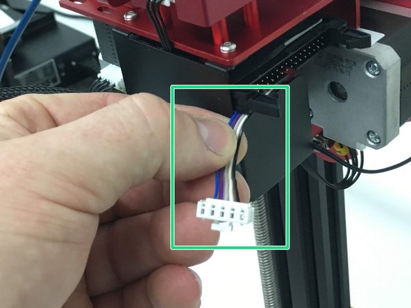

    10. CR-10S Pro BL Touch Install, Top Section  2d.: crwdns2935265:011crwdnd2935265:01crwdnd2935265:01crwdne2935265:0
      • Plug in the ribbon cable up top until you feel the clips on both sides click into place, locking the connection.
      • Plug in 5 pin connection for BL Touch Probe. This plug also has a lock when fully seated.
      • Both connections can only plug in 1 way.
      • If removal is necessary, release locks before pulling on any cables.
