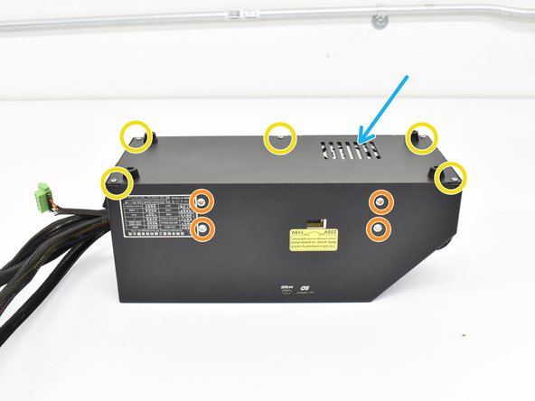

      • Using an M2 hex, remove the 5 button head screws holding the control box bottom cover on.
      • using an M2.5 hex, remove the 4 button head screws holding the power supply to the control box.
      • Lay the power supply to the side as shown.

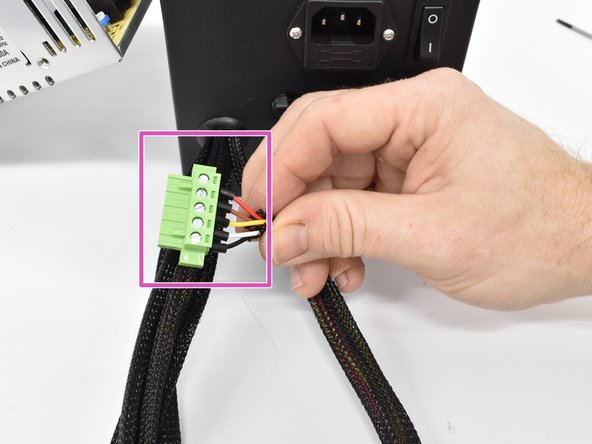

      • With the grommet loose, you can feed harness A through the grommet with the 2 and 3 pin connector going first.
      • Feed it through the hole in the rear of the control box.
      • Leave 4-5 inches of the loose pins and reinstall the grommet.
      • Make sure the grommet is fully seated into the hold.

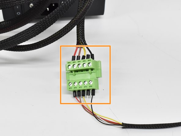

      • Install the male green phoenix connector onto harness A.
      • Using a flat head screwdriver, loosen the terminals 3-4 turns then insert the wires into the
      • Color order does not matter but the other side of the harness HAS to match. When tightening the screw terminals, feel for when the wire end is contacted and do not overtighten. Give each wire a very gentle pull to test that they are all firmly connected.

      • Reinstall the power supply and tighten the screws.
      • Reinstall the bottom cover and tigthen the screws.
      • The vent holes should be positioned over the power supply.

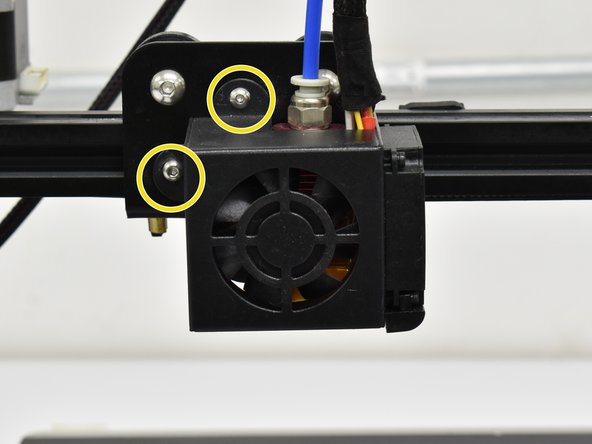

      • Using an M2 hex, remove the 2 button head screws holding the hot end shroud on.
      • Install the bracket using the provided M3x8 (or 3x10) screws.

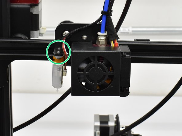

      • Plug the small end connector into the probe. It will only plug in one way so do not force it.
      • Install the probe as shown with the connection facting the hot end. Use an M2 hex to install the provided M3x6 screws.

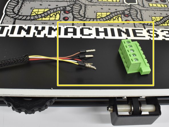

      • You can now install the pre-crimped wires into the phoenix connector. Match the color order from the motherboard side.
      • After tigtening all screws, give each wire a gentle tug to make sure they are tight.
