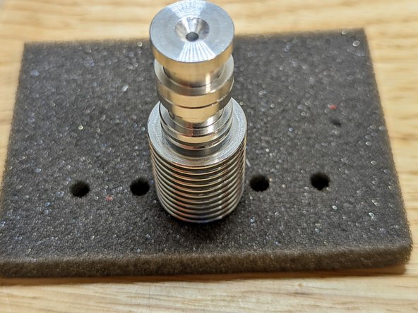

    • V6 RepRap Heat break
    • V5 clone Heat-Sink
    • PTFE Tube which goes between inside the Titan threaded adaptor

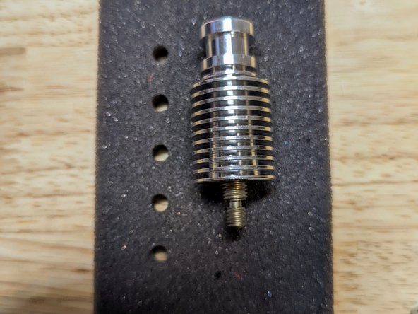

  2. CR-10 V2/V3 all metal hotend, Heat break install: crwdns2935265:02crwdnd2935265:01crwdnd2935265:03crwdne2935265:0 CR-10 V2/V3 all metal hotend, Heat break install: crwdns2935265:02crwdnd2935265:02crwdnd2935265:03crwdne2935265:0 CR-10 V2/V3 all metal hotend, Heat break install: crwdns2935265:02crwdnd2935265:03crwdnd2935265:03crwdne2935265:0
    • Thread heat break into V5 heat sink
    • Boron Nitride Past can be added to the threads to increase thermal conductivity
  3. CR-10 V2/V3 all metal hotend, PTFE Tube install: crwdns2935265:03crwdnd2935265:01crwdnd2935265:02crwdne2935265:0 CR-10 V2/V3 all metal hotend, PTFE Tube install: crwdns2935265:03crwdnd2935265:02crwdnd2935265:02crwdne2935265:0
    • Insert the Bowden tube into the heat sink and screw on the Titan adaptor
    • The stock heater block and nozzle are reused from the stock hotend.
